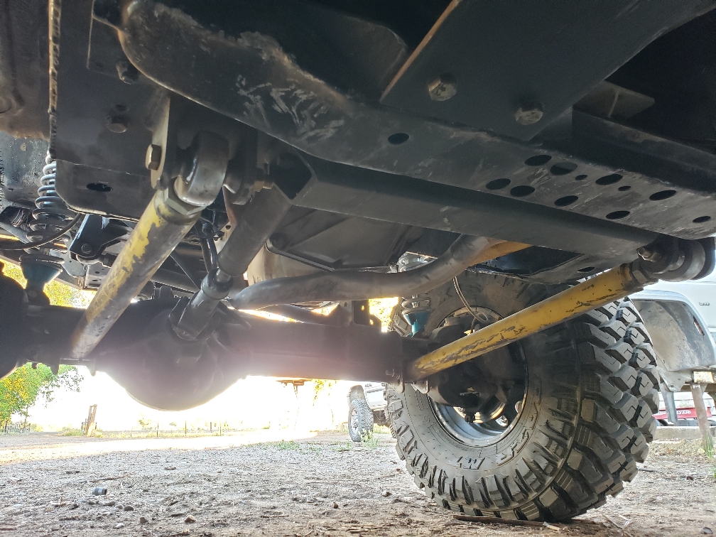

just for the record,
TJ/LJ/ZJ/XJ/MJ Front Upper and Lower Control arms are all the same.
before I 3 linked I ran Rokmen TJ lowers and Currie TJ Uppers for years.
so if savvy won't confirm they fit an XJ its simply because they are covering their asses. can't really fault them for that.

Been thinking about getting some if these. I like to run poly on the axle side.
https://www.barnes4wd.com/Forged-Chromoly-Poly-Joint_c_95.html
My pickup may be first to try these. Been wanting to get rid of castor bolts and run adjustable arms upper and lower. Would run both ends poly on the pickup.
I've had good luck with the cheap ruffstuff 7/8 and 1.25 heims.
you would be way better off with a flex joint, not poly.
IF you do decide to run poly, make sure you significantly strengthen the mounts, as the poly bushings will tear them off.
Rock climber
That reply makes no since. Your worried about poly causing your control arm brackets to tear off. Hmmm the bolt on world must be full of cheap shit.
Maybe I need to read my reply again or maybe you do either way one of us is not seeing straight
i *think* he means that poly bushings will transfer more force to the mount than a heim joint. But not 100% sure./..
More importantly bushings need to flex in all 3 dimensions "x-y-z", only a flex-joint provides that!
Bushings on axle end flex joints on frame side is a good combo. I get no bind on the axle side poly joints and they keep the arm from flopping side to side.
If I was binding on my poly at the axle theyd be all chewd up.
