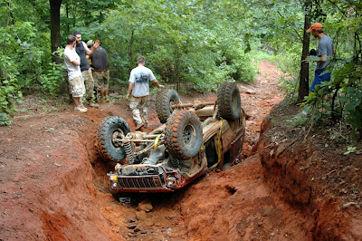

I have seen a rig on 36" IROKs survive on a d-30 front end, then break in a bad spot and end up in a rollover.
In the D30's defense, it was in a REALLY bad spot.
