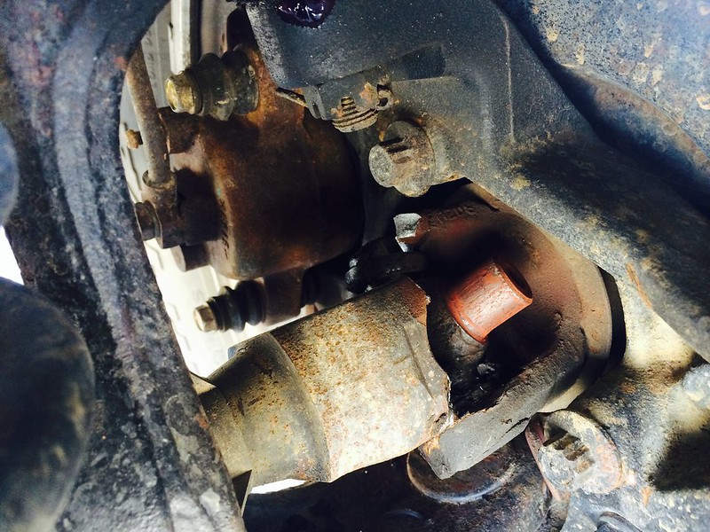

I broke my short shaft, at the joint on my 30. It is a 94 axle, with 4.56's, stock shafts and a Lockright. I run 33's. The tire got caught while I was backing off of an obstacle.
The joint was non-greaseable and it was clearly dry. Boom, perfect recipe for breakage.
Broken Axle shaft by Sean Mitchell 707, on Flickr
Untitled by Sean Mitchell 707, on Flickr
