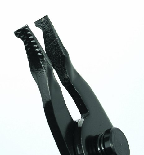

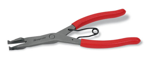

Does your shop include large snap ring pliers? That's the only thing I needed since my three other sets were too small. Everything else is various sockets and wrenches in pretty common sizes.
Get a set like these Now. Before you start. Most use a lock ring and these make it Much easier and with less change of curse words and yelling.

1. Snap ring pliers a MUST. I cannot imagine doing this without them
