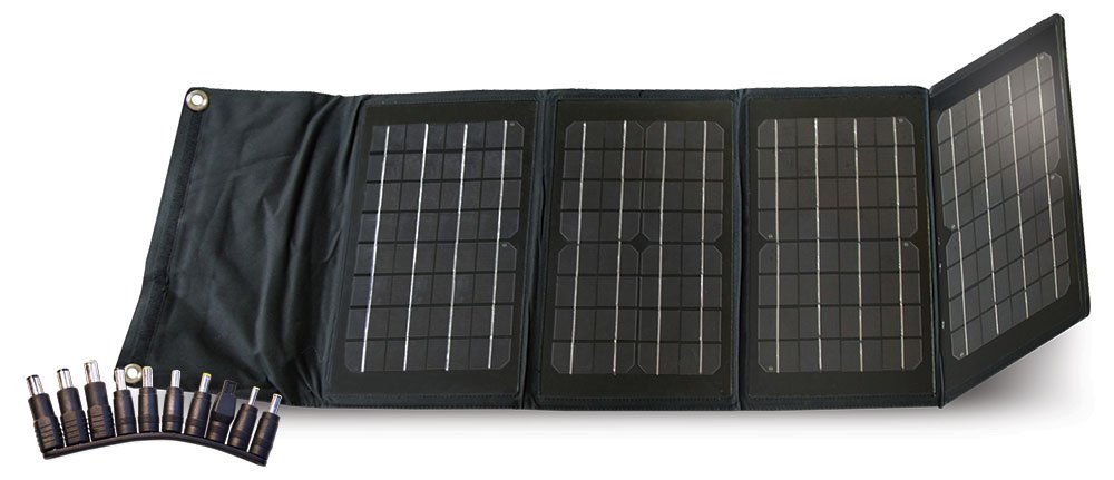

Great Pics and descriptions! Do you have pics of your folding solar panel? I would like a more detailed description on where you got it, how it works, etc. Thanks.
Folding Solar
We were going to mount a big panel on the roof in front of the luggage rack (15x45" is perfect as I recall), but theft and the inability to take it with us if we got stranded and had to leave on foot swayed us to a foldup unit.
This Nature Power unit seems to be the best output for the buck - man they get expensive fast! Claims 40w but we have seen 1.8 to 2.1 amps dc in good sun so far. I tie this right into the binding posts of my inverter (which is in passenger doorjam as above) so it's an easy connection and the panel sits on the roof. We can even bungee the panel in the luggage rack if we need to move the XJ around.
Listed specs:
40-watt monocrystalline solar panel for charging laptops and 12v batteries
Opens to lie flat: 51-inch x 16.5-inchw. folds to 16-inchl x 10.5-inchw for easy storage.
2.2 amp at 18vdc
Safe for outdoor use
Includes 12-feet wire, 10 laptop adapter plugs, battery clamps.
It comes with all those adaptor plugs also, but I don't use any of them. This one is $300 and they have a double sized 80w for $600!

Re: Folding Solar
Great info. I think the smaller one would be great, but I also wouldn't mind the larger one for my travel trailer. Where did you buy yours?
Well price per watt I did not find better to buy it than Amazon.
