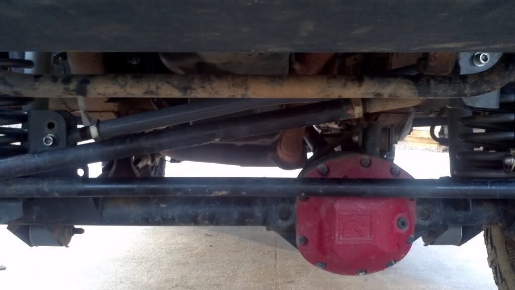

JCR 1-ton over knuckle with TnT's track bar with over axle mount.. IMO best DD and Wheeler set up there is.. 1ton TREs last for almost 3 years of driving and wheeling before 1 decided to wear loose, loads of clearance and the TNT track bar maked it easy to get my angles right..
