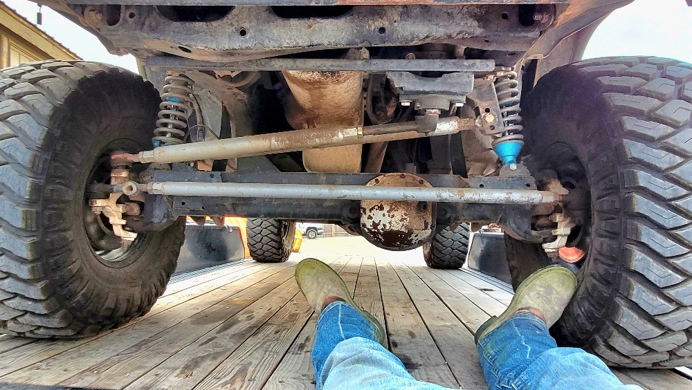

Im not sure about the wj +5" width as the xj tie rod is a near match for width on the wj knuckles. Though thats neither here or there.
I havent run the cv axles I thought abought it but didnt for aome reason.
Actually as I type this a guy fully knows the wj is not 5" wider after swapping on wj knuckles. Its what a 1/4" maybe 1/2" when air gaps are accounted for.

????? Putting WJ knuckles on an XJ/ZJ/MJ front axle? If so, that isn't the issue. The cross over steering link is 5" longer so.
Had to search the internet:
https://www.hkoffroad.com/pages/xj-zj-wj-axle-information
XJ D30 60" width vs WJ D30 65" width.

Yes, WJ knuckles and brakes on an XJ/ZJ/YJ/MJ is a common upgrade. I think a lot of people do the work themselves as far as sourcing parts but there are a few companies with full kits avalible.
https://www.stinkyfab.com/collections/xj-steering/products/sfr-basic-wj-high-steer-big-brake-kit-xj
The WJ stock steering wont work because of the obvious width difference but I believe you could temporarily still run the stock XJ/ZJ/YJ/MJ until you built your own DOM Steering setup.
The xj drag link is not long enough actually ummm
Ill look into the 5"
Xj tierod
I guess wj houseing might be 4.5" wider
My posting was that the axle shaft of a WJ would be longer, by the 5 inch difference. Also, I think they are CV joints. I don't know what their strength would be for wheeling.
I did use the Ruffstuff 1-ton GM kit on my first WJ BB. On the next I gathered parts. Should have used the Ruffstuff.
When at the Pnp, I did try the XJ TRE taper in the WJ knuckle. Seemed to fit. I remember someone using the stock XJ steering setup with WJ knuckles.
Do have the Stinky Fab OTK trackbar setup on my 2000 XJ. Excelent stuff. Beefy.
