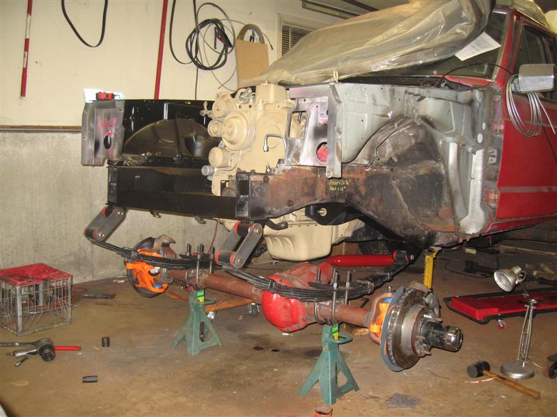

Good point, I forgot about Dan's build on 4x4wire.com.
He is using the Chev 60 degree bellhousing from an Isuzu mated to an AW4 (IIRC).
so using the mitzu diesel would be the better way to go . sorry i am a little confused with all the back and forth chatting . will the mitzu motor bolt up to the aw4 bellhousing ? or will i have to use the mitzu bellhousing with the aw4 ? does anyone have the correct part numbers . and reguarding weight i have heard the 4bt weighs 750 lbs from many sources how much does the mitzu motor weigh? i have also been thinking of getting a grand wagoneer and putting a diesel in that . it should be able to hold the weight of a heavy duty diesel no problem
It's still work in progress....
