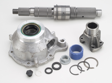

Wait, so the rear RE DS that is for sale here won't work with a RE SYE or Teraflex, AA, etc SYE? Am I completely misreading this?
it will not work with any SYE that uses a yoke on the tcase side, only a flat flange.
like this:
not this:
Damn it! I just bought a Teraflex SYE (the second type pictured above) and was hoping this DS would work. I suppose I could return it for the "hack-n-tap" but have heard they aren't the best route.
