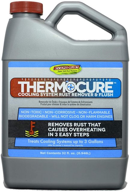

This is the stuff I used after bit of research (and tapping up my local mechanic for his tips):
I don't know if you chaps in US can get this but it certainly helped properly flush my system after the poor old '96 had suffered years of neglect.
Interestingly, whilst I ran it during a 300 mile trip the coolant temperature ran approx. 10% less than without.

We can.
If that stuff works as good as the EvapoRust does on rust then it should be really good.
