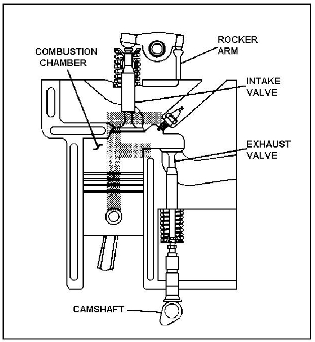

Went down to Westcliffe and pulled a 1957 Willy’s Jeep CJ5 out of its resting place amongst the trees and weeds. The foot wells are rusted out and the right rear corner was smashed ages ago, but it’s mostly original and all there. Now to decide what to do with it. A big part of me wants to stretch it into a CJ6 and put the XJ’s drivetrain/suspension into it. Another part of me just wants to grab a 6 volt battery and see if I can get it going. Just putz it around in stock form and use it to plow my neighborhood.
Re: The Colorado BS thread
There's a couple hours of my life that I'll never get back!
https://cj3b.info/Hurricane.html
If it turns over, and makes compression, it could be fun to tinker with. Otherwise, stick to your area of expertise and put a Diesel in it. ;)
