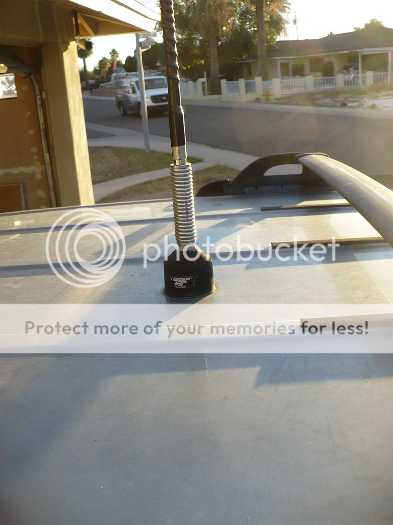

CB pros, I've screwed up my ant

The FireStik website FAQ's and other pages are full of illustrated diagrams with trouble shooting and installation info
A properly located and tuned antenna set-up with a 4 watt CB should transmit clearly for 1-3 miles.
Why do you think it is assembled incorrectly ? Looks correct to me.
FireStik has large and comprehensive FAQ and Trouble shooting sections with pictures and diagrams. Right Channel Radios is another excellent resource.

Coiling the cable is bad, also your antenna position effects where you get the best reception and with yours you should get the best reception from the left/rear.
What sorta ground plane will I get from left rear? Why is that location better???

The "ground plane" is everthing to a antenna. If you mount the antenna on the rear, your best performance will be in front of you. If you mount it the front your performance will be in the rear. If you mount it on the right it will be from your left. If you mount it on the the it will from your right!

A good example would be a fiberglass boat or rv where you have to "create" a ground plane for the radio to work.
My limited understanding is that the best antenna location is the middle of the roof. Best to get the fat coax wire, not the skinny stuff for less loses. Ditto on do not coil it up. Keep cable short as possible. Tune your antenna length with a reflected power meter.
and never ever transmit with the antenna disconnected, as that can fry the radio as the power will all be reflected back at it.

BTW, you can cut the coax length but it is the least recommended. The factory cables usually come in 9 or 18 feet because they are factions of a full wave length (36.66 ft) and you should to get a faction of that or tuning will be the most difficult!
