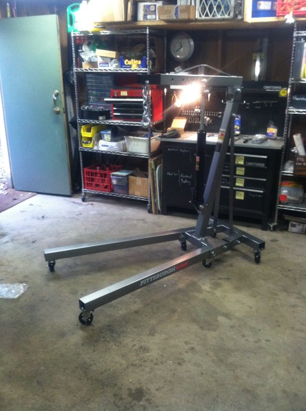

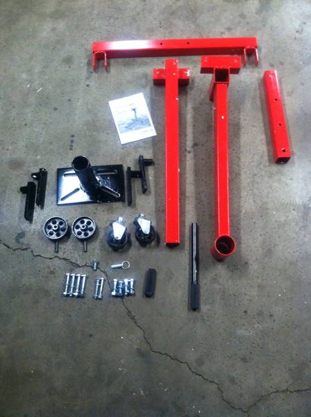

Calling the rebuilder for prices today. And I got some work done...

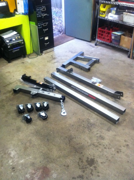

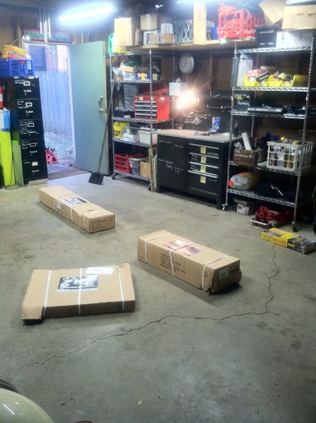

Harbor Freight FTW - Engine Crane, 1 ton engine stand, and load leveler
It's a little air compressor, but it should be enough to power my impact wrench with a few repeated bursts. Thanks Dad for Christmas!
Load Leveler, don't know if I'll need it or if it'll even fit yet.

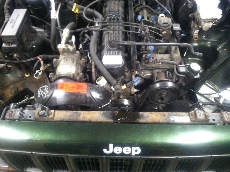

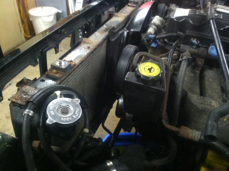

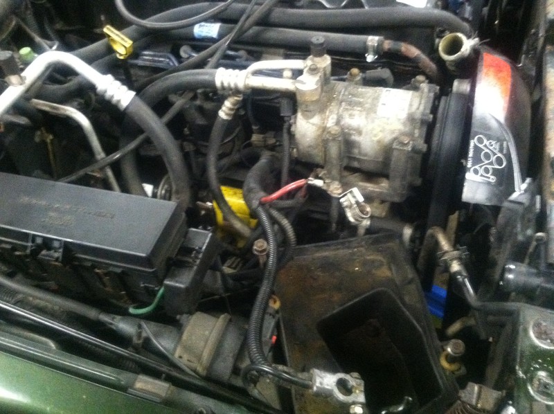

More work done today. I somehow managed not to break any bolts today. Both PB blaster and a feel for rust grit in the threads have become my friends. I've gotten better at feeling the resistance from rust, then work the bolt back and forth until it becomes easier to turn in both directions. Hondas didn't have this problem. With Jeeps its a skill.
Oops, nevermind. Forgot I broke the coolant reservoir hold-down bolt (tiny little heads on those things). I wanted to rinse as much dirty coolant out of the system as possible.

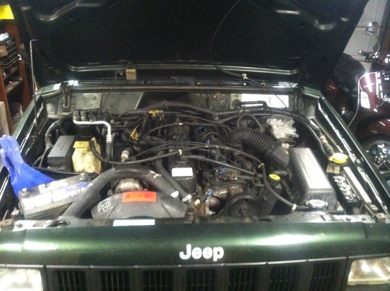

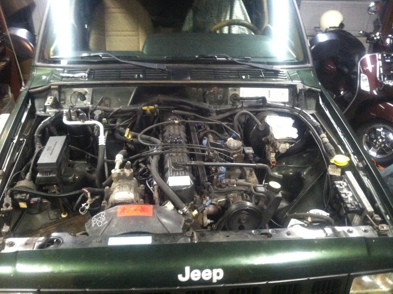

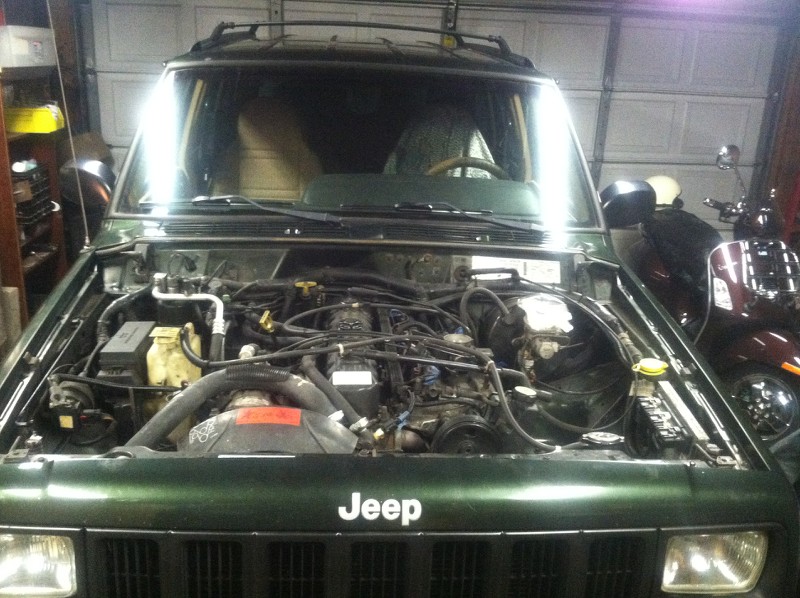

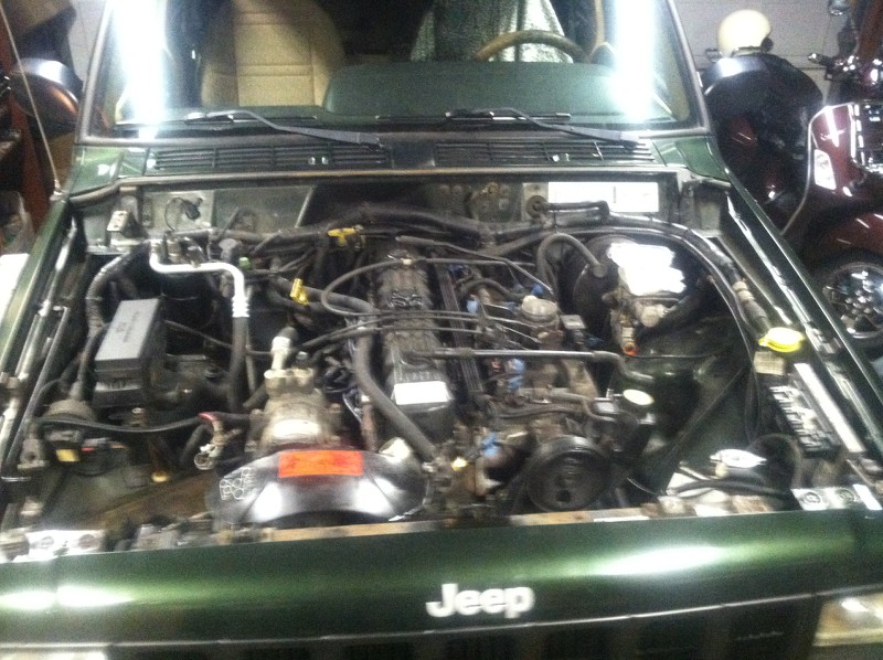

Slow progress, slow build with picture overload...
Battery and Air Box
Hood Off

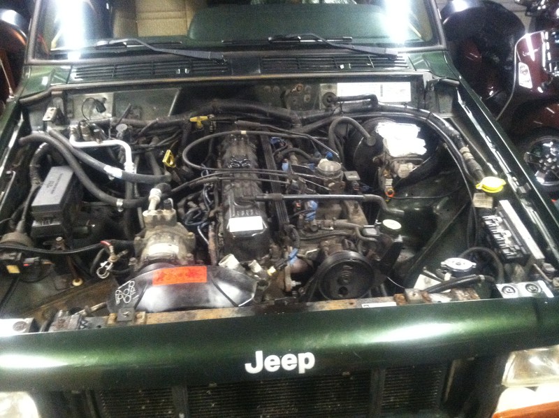

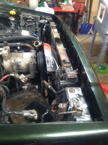

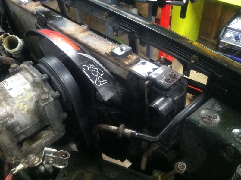

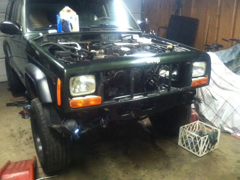

Progress:
Radiator, Condensor, bumper end caps, and bumper are off. Tomorrow I'm taking off the header panel for better access, and then am going to start removing and tagging everything off the engine itself.
I had trouble getting some of the transmission lines off the radiator and have another thread floating around for that.

If by "easy" you mean "a colossal pain in the ass.". I ended up hacksawing the fitting off my old radiator so I could at least turn the fitting up and look at it while fighting with that damned tool. Took me as long to get that fitting off as the entire rest of the disassembly job to replace the rad.
It is pretty easy to remove the lower transmission line at the radiator with a tool like this http://www.oreillyauto.com/site/c/d...word=quick+disconnect+tool&pt=N0044&ppt=C0052
Yep, that's the tool set that I had. The sucker wouldn't budge and I'm replacing the radiator anyhow, so I cut the tube that runs off the radiator on the radiator side. I'll deal with it later.
The thread is here if anyone else runs into this problem:
http://naxja.org/forum/showthread.php?t=1108769
Haha, glad I'm not the only one!
