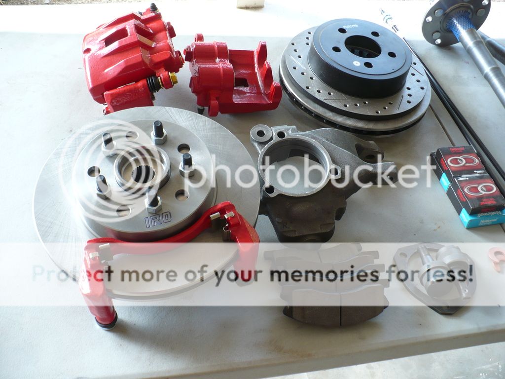

Wilwood sells multiple kits and there are a few DIY combinations for the the pre-1990 knuckles. They have a bolt-on bracket to hold the caliper and pads while the later-model knuckles integrated it all into one casting. If you happen across a set of OEM early-model hubs with a big nut on the backside, they are rebuildable...
Get the older knuckles with bolt on caliper brackets and run 4 piston Calipers with mustang rotors. Research it

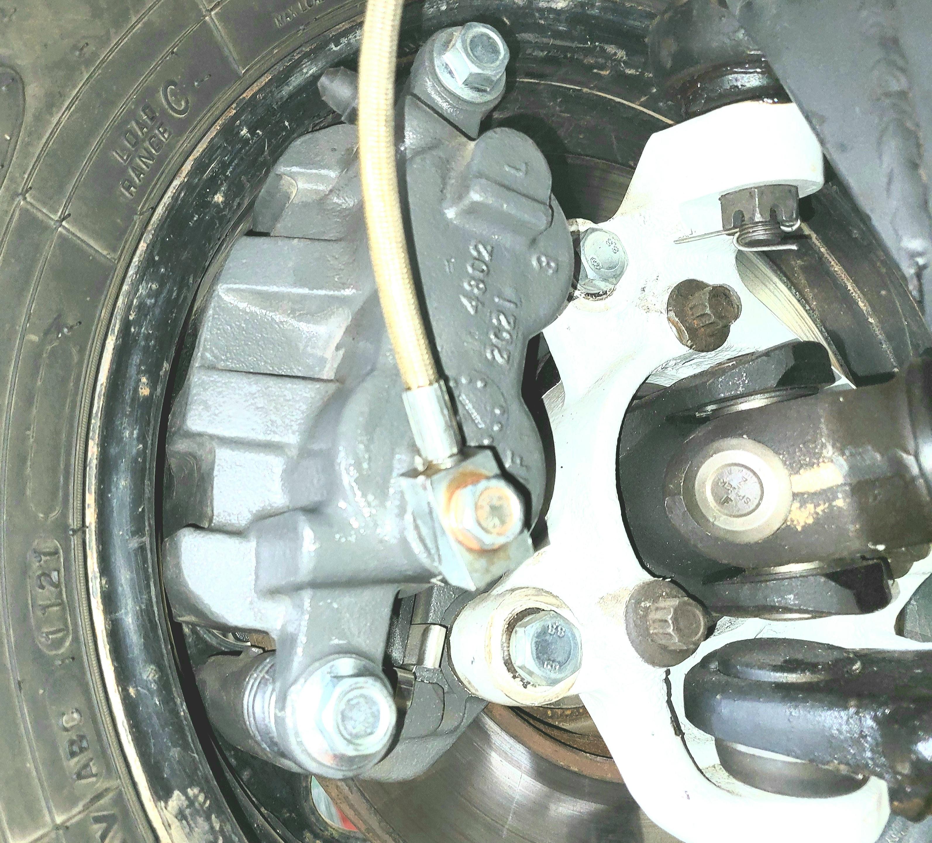

I've done two WJ Big Brakes, and converted one to 5 on 5. I did that as some WJ rims came up. Originally I ran some 15 inch Canons with spacers.
My present setup I used 2000 XJ 16 inch aluminum rims. 5 on 4.5. I think they are call the unlimited. I did try some steel rims, but the binded on the caliper. I went with NAPA Reactive and Adaptive pads and rotors. I think you might want to look at Black Magic pads.
