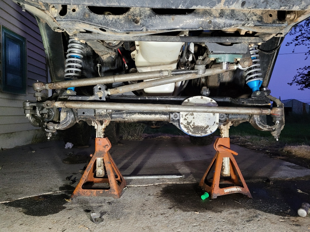

Like usual I just couldn’t stop, ran the reamer a little too deep on my knuckle, then did it again on the other side. So I cut some copper tubing and used it like a bushing so the TRE’s would seat better. What’s the worst that could happen? I figure I’ll know if it wears and gets loose. Right?
Thanks I couldn’t remember what size hole the inserts needed. I’ll measure tomorrow. They’re deep enough so that the nuts will barely bottom out when installed. Then the joints would have very little articulation.
They make them in 7/8" or 1" but if your talking about XJ knuckles they are dirt cheap at the P-n-P.
One of mine was a bit to deep. I did as Evans recommends and drilled for an insert. Worked well. I did my next WJ knuckles with inserts. I'd prefer having them reamed though.
Thanks so much guys. I’ll be ok with inserts-my widest point is .85” right now. But I will see about new knuckles as well. That way maybe I won’t have wasted the money I forked over for the reamer.
