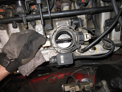

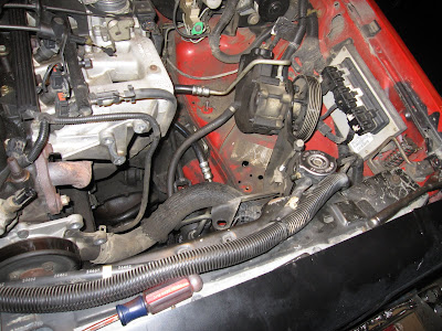

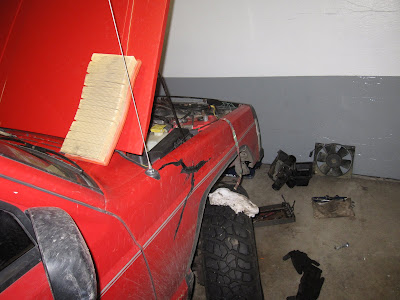

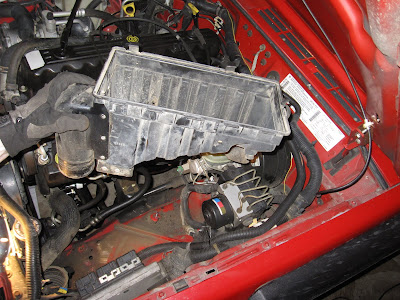

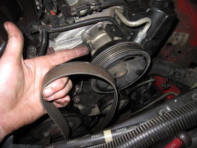

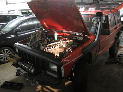

remove Airbox
cover Throttle Body
remove Electric Fan
reduce tension and remove Serpentine Belt
remove Power Steering Pump

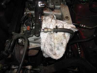

disconnect Fuel Line at Fuel Rail

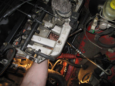

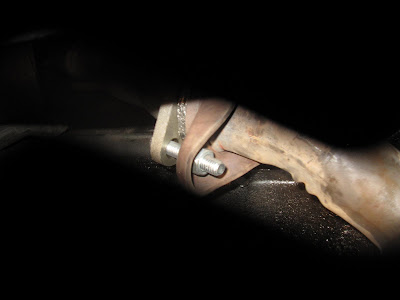

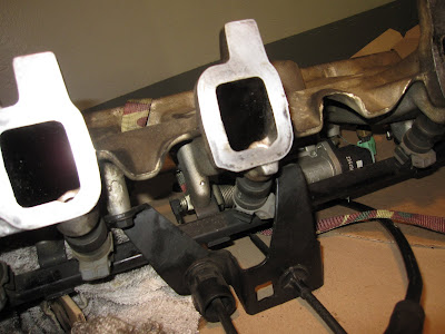

Swivels and Extensions required for Manifold Bolts
many hard to reach Manifold Bolts

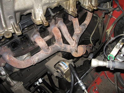

Re: APN Header Photos

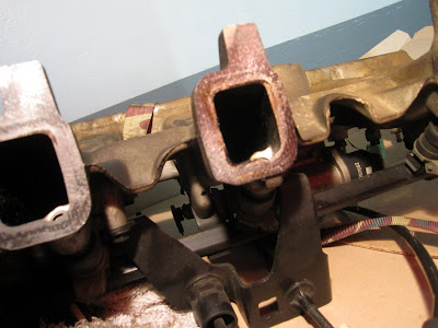

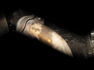

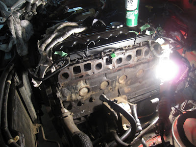

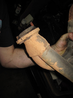

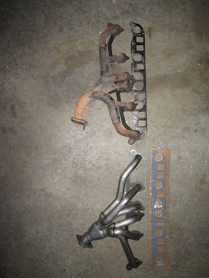

Exhaust Manifold (Header)
Header cracked almost entirely around one tube at the Collector
Header removed

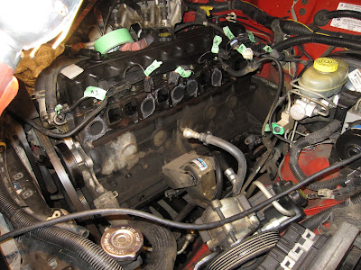

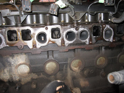

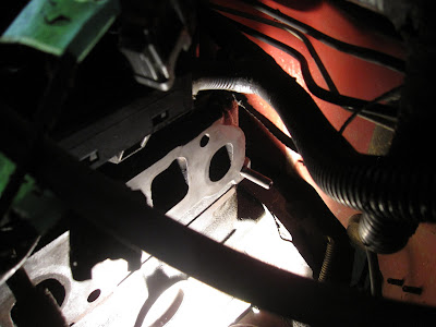

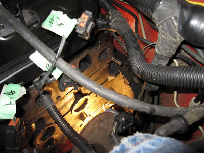

Injector Wiring and Sensors labeled for ease of re-assembly
Intake ports [] and Exhaust ports () in Cylinder Head

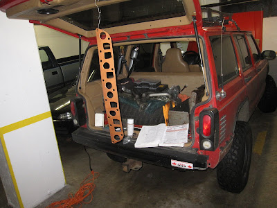

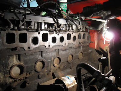

Gasket surfaces prepped through scraping, sanding, conservative use of solvent

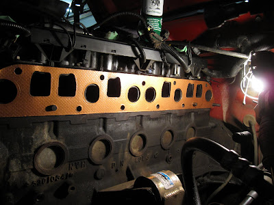

spray new Gasket with Copper High Temp Adhesive Sealant
Cylinder Head prepped
Copper sprayed Gasket resting on alignment pins

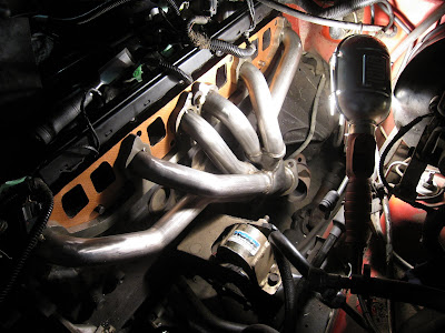

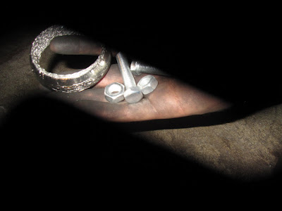

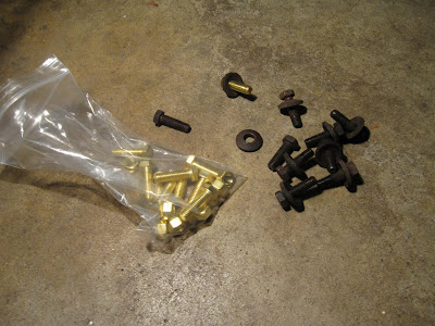

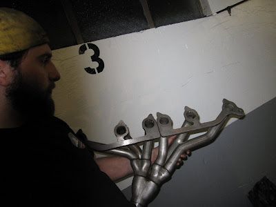

APN Header
new Brass Hardware

Installed

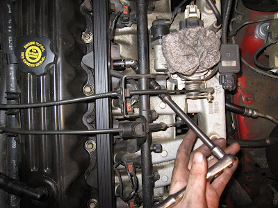

Swivel Head Gear Wrench required

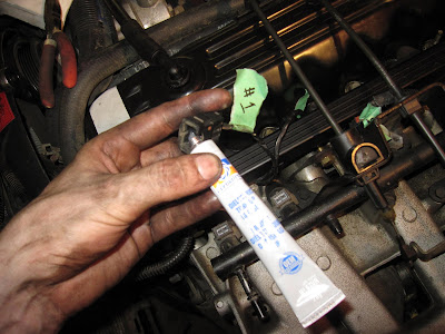

apply Dielectric Grease to all electrical connections on re-assembly
Good info! As someone who's been through this recently (several times on my Jeep and a couple of others), while you have the header off and everything out of the way, take a good look at your motor mounts, especially the drivers side. If they are in bad shape, your new manifold will crack eventually. Mine lasted about 6 months and this is why:
Great time to replace them is while you already have everything off. Even if you don't have much money and want to go with OEM replacements from your favorite parts house vs. ordering after market ones online.
If you look in his pictures, he already replaced the motor mounts with some type of aftermarket unit. Look like M.O.R.E.s.
Good advice in general though
