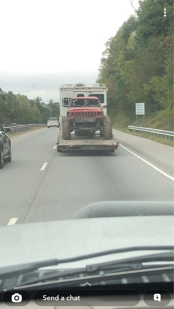

Alright so finished this weekend in a good note. Not where I wanted to be but not bad. Got the axle brackets and links burned in and it all back under the Jeep on its own weight on the coilovers. Carefully got it loaded onto the trailer and over to my buddyís place and got the crossmember burned in. Then pulled it in to get the front coilovers done. I had opted to just order pre bent tubes rather than bend them myself just for time sake. Got the hoops are mounted and tacked in everything seems to fit pretty good. Will probably be back over there Tuesday to finish burning it all in and start on a hoop brace. Still need to weld in my atlas support, run my battery cables, mount my battery box all before this coming Saturday. I want to take it for a test run before I take it all the way to Harlan for the 4th of July.

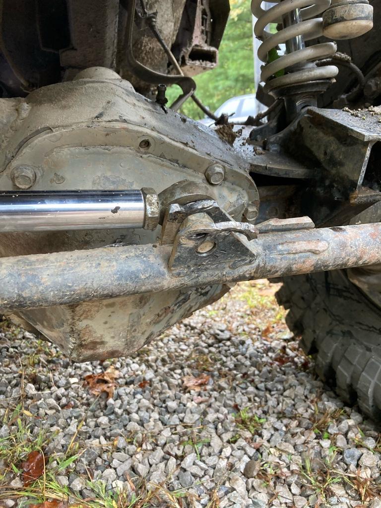

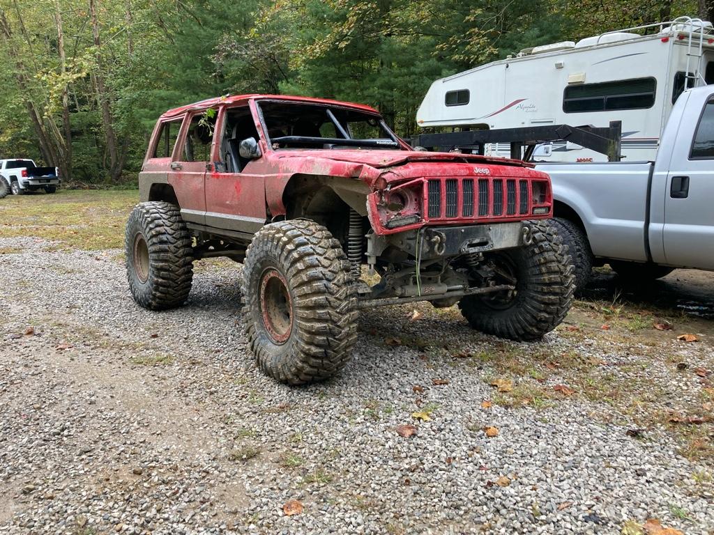

Well I did pull it all together and headed to Harlan Thursday afternoon. The weekend went extremely great until Saturday. During the lower rock garden shootout I launched the front end a little too hard on the last ledge and broke both coilover tabs sending both them through my hood. All fixable but still frustrating. All in all though the Jeep did really well. Still have a few kinks to work out in the rear and I have to cover up some of the holes in my floor along with the front coilovers and she should be good.

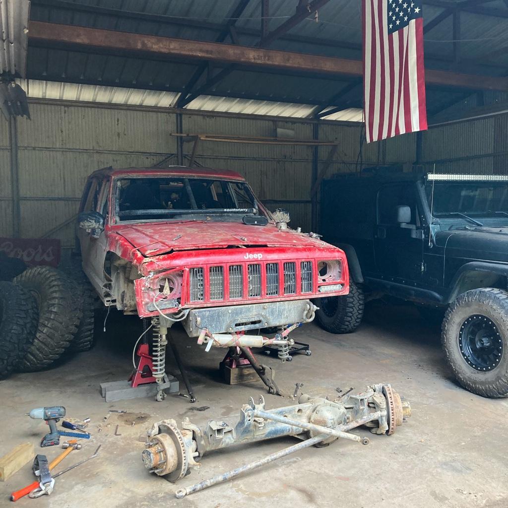

Finally got the Jeep over to my buddyís place today to get these shock mounts fixed. Got some new tabs cut out already and will probably get those on sometime this week. Then it will be bumpstop time. I will probably mount something temporary for now till I can get some air bumps, just to keep this issue from happening again. Then it will be back to the house for suspension tear down and reinstall. I have to take down my links tighten the jam nuts paint them and put them back in. I also have to rerun and permanently attach the brake lines on my rear axle. Should be good to go after that. Also picked up something else to take more of my money and time.. been wanting one for a good while now and finally found one that wasnít rusted out and 10+hrs away so scooped it up. 1981 AMC Eagle SX/4. Not sure what Iím doing with it yet but if I do keep it should be a fun little ride.

New shock tabs are cut and cleaned.. will probably try to set them up sometime this week and get the Jeep on itís own shocks. Then will come up with some kind of bump stops. I will eventually be on air bumps all the way around but for now just going to come up with something cheap that works.
