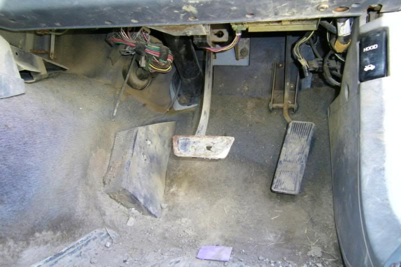

The floorboard and under dash:
Not sure if that foot rest is OEM, but I imagine it's a good idea since the trans tunnel is closer on the right side - keeps your foot from moving under the brake pedal.
The gas pedal doesn't have the same amount of movement as ours does - not sure if it's been bent/damaged, but the throttle only opens 2/3rds of the way. Seems like the rise of the floorboard for tire clearance keeps the pedal from moving down far enough.
You can see that the wiring harness comes through without using the junction box/fuse panel we're used to seeing. The fuse panel is actually that tan/greenish box just under/behind the lower trim panel.
Kinda odd to see the hood release over on this side as well.

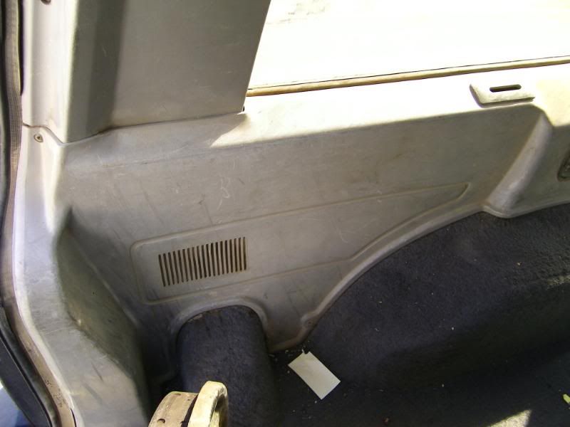

Can you tell what's missing here?
It's mounted over here, but not with a factory looking bracket..... Wonder what they did with the spare normally in an RHD XJ? Maybe it was a delete as part of a Postal vehicle order?

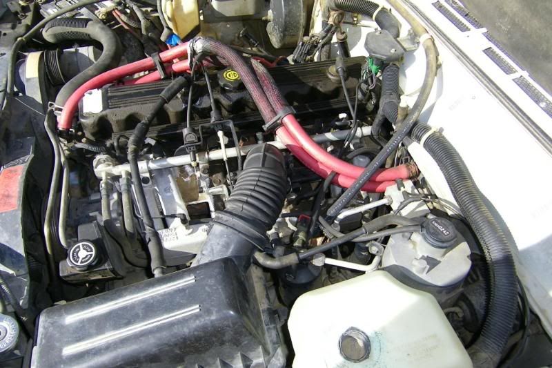

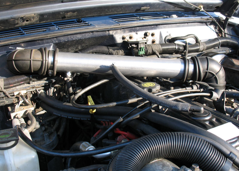

Lots of oddities in the engine bay:
-Spring loaded belt tensioner where the AC would be

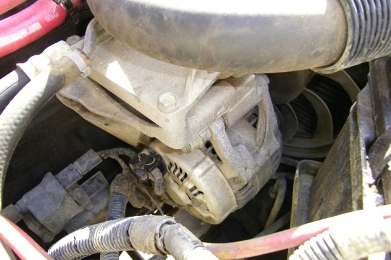

-Alternator is mounted higher over the steering box
-Fans are reversed
-PS pump bracketry is non-adjustable
-PS hoses run across the engine
-AC is down on the other side, in the space where our steering box is
-Transmission cooling lines go into the radiator tank on the right side opposite ours

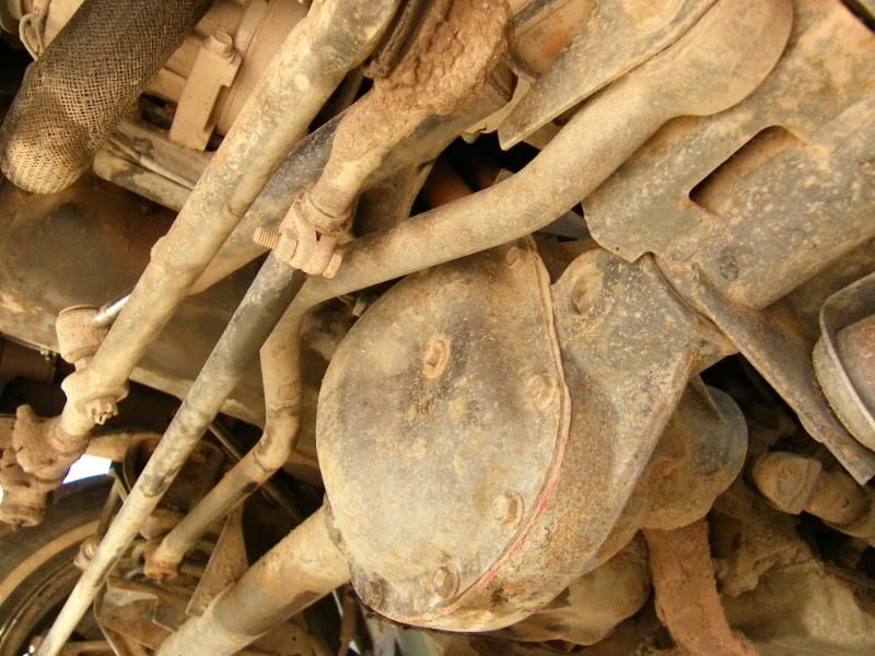

One very screwy looking track bar.......

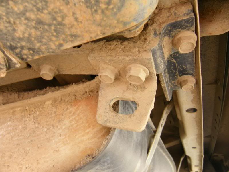

I had never seen tow points like these. Maybe gov't order option?

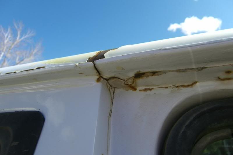

Other than these things...... just another XJ.... with hideous unibody cracks.... I guess rural roads can take their toll!

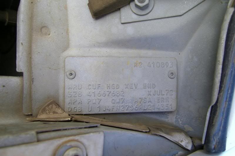

Here's the trim tag. Anyone able to tell me if this was manufactured in the US or overseas?
Had to keep a memento......
1st Position ..... 1 = USA
11th Position ... L = Toledo
Have found made in japan logos on the RHD 97+ dashes over here ... Maybe chrysler didnt want the US market to know they had to import gauges ...

Spare wheel is factory fit on rear right hand corner - bit better brackets than in your photo tho ... thats probably a bodgy replacement. Some were still left rear corner fit too.
The red heater hoses look after-market ... All the ones Ive seen lay along the engine length as usual.
Pretty sure the towpoints are stock. They arent winching recovery points just tiedown/tow points.

EDIT: yeah, those red hoses are aftermarket... the factory ones are form-fit just like the LHD ones. I seem to recall from a recent CPS thread by an RHD owner that the OEM ones cross over the top of the tranny tunnel and were making his marginal CPS cut out when he turned the heat on (this confused everyone till it came to light that he owned an RHD XJ), but I could be remembering this wrong.
