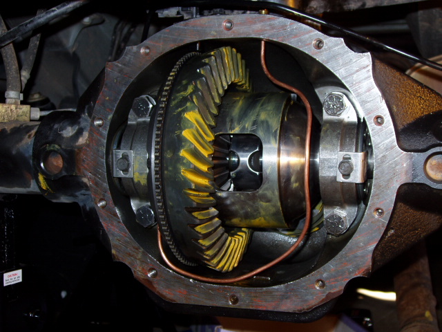

Originally Posted by 4x4JeePmaNthINg View Post
Sorry to keep beating this shim thing to death, but use love to see this set up if you ever find yourself I there again.
Is this shimmer set up called any thing or can I Google something to get a visual?
I like the pedal response your getting from this.
Not my pic but the shims would go in between the c-clip and the side gear.

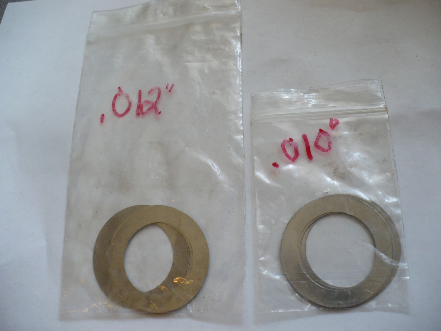

Here's the shims, IIRC I got them from McMaster.......

Ahhh, gotcha, that's not quite what I pictured. I was think something more fitting with the pocket for the c clip.
I have an arb, it might be tricky to to get shims in past the retaining ring thing . I think I may still have some extra various sized C clips from ARB, perhaps some wider ones.
