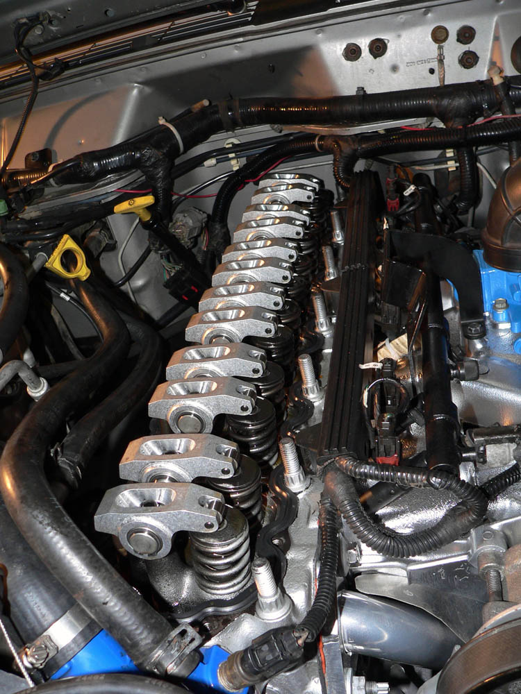

I've done 36k miles on my YT6627s (1.6 ratio) without issue so far.
I don't think a set of 1.7 ratio rockers will do much for you especially considering the cost. A bored 62mm TB will help a little and sharpen throttle response. You might also want to consider regearing the axles.

With the 232 cam, you already have decent lift. You can go with the 1.6 YT or Harland 1.6 (cheaper) and benefit from reduced friction, quieter operation, more consistent 1.6 ratio.

With the 232 cam a set of Harland Sharp 1.6 roller rockers will do fine.

If you go with adjustable Harland sharp rockers you will need a valve cover spacer. Don't know about the non. Harland's support is exceptional and their rockers are rebuild-able.

After 8-10k miles look great, no wear.
