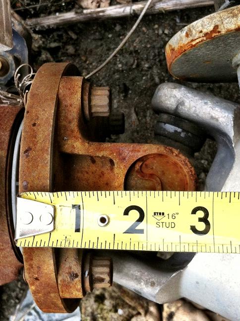

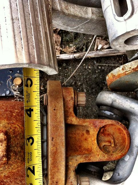

Took these pics of my "new" to me 8.8s flange. Is anyone able to look at the pics and say which size I have and which new yolk I need to order to work with the XJ?
Sorry I'm not sure where I need to measure from so I just kinda guessed.

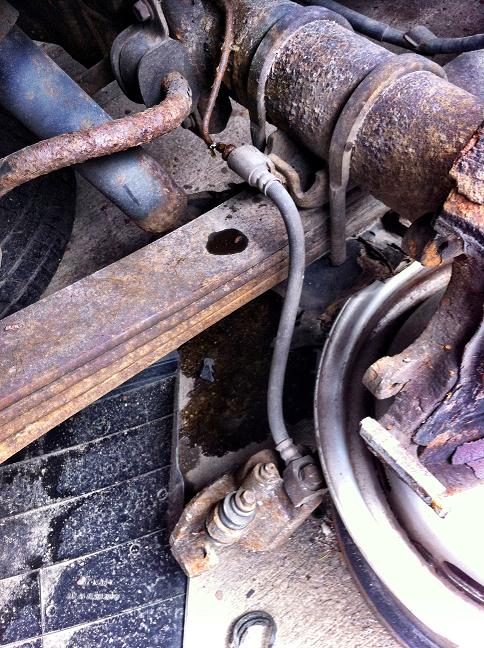

I also found a mountaineer in the JY but its just as rough and has 3.55 gears. But it does have all the brake stuff to look at. I see what ya'll mean about the odd ball drivers side flex line! So if I order two passenger side ones and run hard line between them with the facotry XJ splitter thingy between, will that work?
Should work just fine, that's what I planned on doing myself.

Here are pictures of the 2 flange sizes. The one on top is the size that fits on the XJ.
You can see in that photo that the "crosshairs" or whatever you want to call them are set into the flange base a little bit. The bottom one measures just shy of 4" from outside to outside of the "crosshairs." The top one measures just shy of 3 1/2".
Here is another shot side by side. The large one is flat on the workbench, while the smaller one (the one we use) is tilted against it, resting so as to see the difference in width of the "crosshairs."
Hope this helps.
