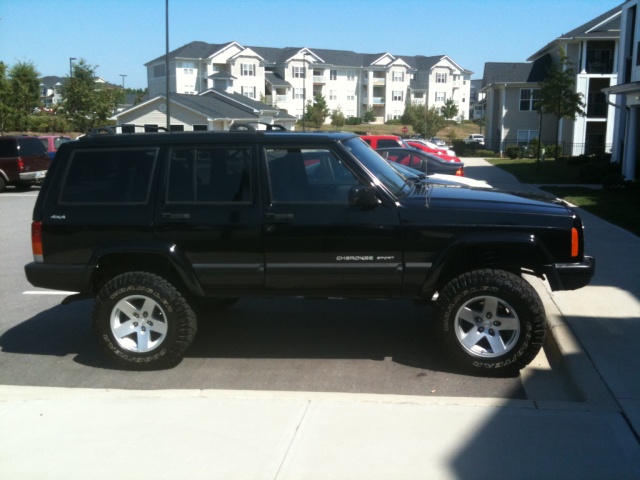

For now, I managed to level it out:
Ummmm, I hate to tell ya buddy, but if you spend the money on a set of 31x10.50's, you're gonna be pissed! A 245/75/16 is the SAME EXACT height as a 31x10.5R15. The 31 is wider, obviously, but they are the same height. Goodyear lists the specs on your 245 duratracs at 30.5" overall diameter, and you guessed it, 30.5" overall diameter on a 31x10.50R15
it is your rear that sits a little high right? i wouldnt stress it too much man. after 3 years mine is still raked out. and to be honest id have the back higher rather than the front. just tell yourself, "once i get that rear bumper/tire carrier and roof rack and have all my camping/fishing/wheeling gear in there itll be sitting proper." :)
and i agree that the 245 is almost exactly the same as a 31x10.50. i didnt notice that the first time around. :doh: little tires mean lots of flex though. haha. get 4.10s in first and see where you wan to go. your build plans may change by then. the problems with those rims and bigger tires is going to be backspacing... are you running spacers?

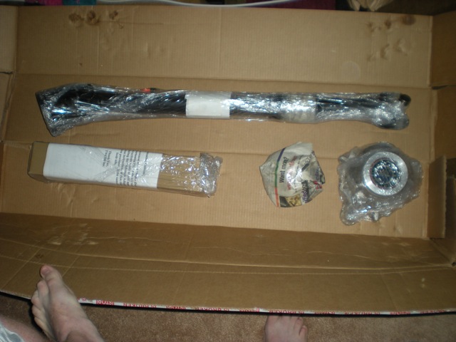

Just ordered the XB double-cardan shaft and Super Duty SYE from Tom Woods. Should receive it early next week, and will document the installation process (since I've done a crappy job of doing so thus far). For those who are curious about the Super Duty SYE, it has an output flange (rather than yoke) and a hell of a guarantee:
http://www.4xshaft.com/SD231.html
The guarantee alone is worth the extra $50 in my book.
Next up is a quick CAD mock-up of a Backbone design I pitched to Mark over at Detours (to allow a 2" receiver instead of a winch plate)... It's feasible in my head, and he expressed interest in seeing it, so we'll see where this goes. It'll involve multiple pieces in place of the pressed winch/main plate, but it very well might work (and leave options regarding receiver placement - above bumper, in bumper, and below bumper).
Looks like the driveshaft and SYE are out for delivery right now... Reminds me of waiting on Santa or the tooth fairy as a kid.
Now, the question is this: should I install the kit with the transfer case in the car, or remove it and do it on a bench? If you've got experience with both, I welcome your input - I'll do whatever is the best compromise between ease of installation and estimated time for each route. I'm leaning toward removing it just because I won't be stuck under the damned car for so long, and it'll give me a practice run for installing the 242 I have on the bench in the future (the only reason I opted to upgrade the 231 is because I haven't yet had a need for full-time 4WD, I still need to locate a shift gate/indicator plate and appropriate linkage, and determine whether or not the output shaft is splined for a speedometer gear since it's from a 2003 WJ).
