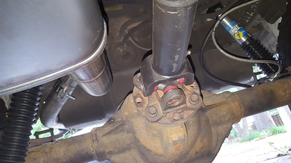

So the "grinding" that kept me from bringing the rig to COFest ended up being the muffler. With the rig loaded down for camping I lost enough lift height that the driveshaft was kissing it on every revolution. Annoyed that I wasn't able to see if the morning of, I probably could have BFH'd my way to Buena Vista.
i.php
The muffler was rusting through so it was on my list to replace anyways. I could not find anyone who has run this so I decided to give it a shot. I needed something considerably smaller than the stock muffler but I am not a fan of loud exhaust.
On this rare occasion the old stuff came right off and I had the new pieces on in about an hour start to finish. Plenty of clearance now and I am pretty content with the sound. It has a nice rumble to it but not obnoxious at all. Haven't tested it yet for drone on the highway but I took the RPM up and am confident it's not going to be an issue.

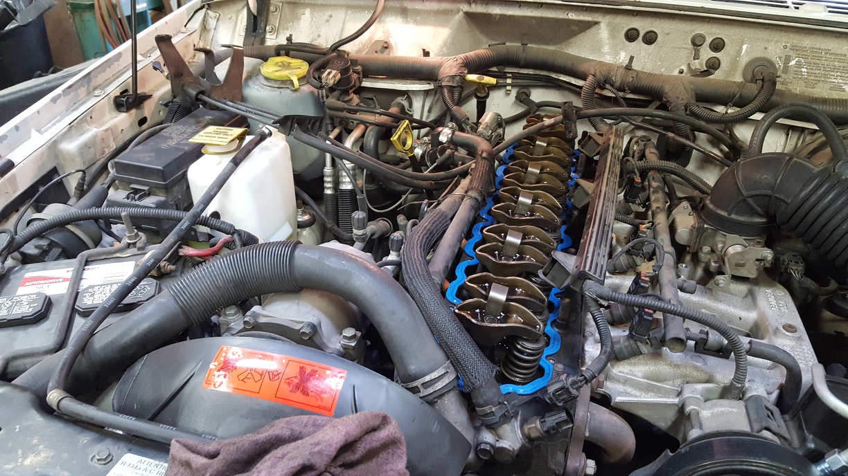

Picked up some other goodies as well. Valve cover/oil pan gaskets, rear main seal, new pcv stuff and a fan shroud. My old shroud was missing the top half of it. I've done the vc, shroud, and pcv stuff so far. Will get to the pan and seal at some point. It's got a pretty significant oil leak.

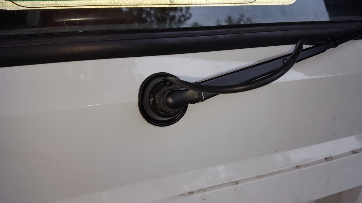

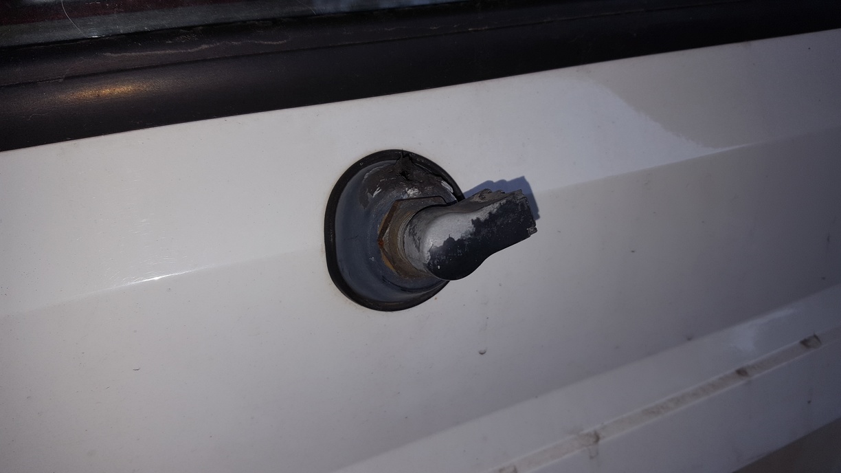

Oh and before and after on the rear wiper.
Where did you get your tailpipe? Do you have a part #? I haven't been able to find a nice piece without crappy pinched bends. Looks like yours is mandrel bent.
Yep, that's it. Bought it straight from Holley as well, I did not see a lower price anywhere.
