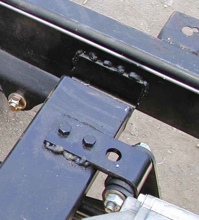

started on the front crossmember last night. i am using 4x4x1/4 angle that will be tied to c-rok plate on one side and matching plate on the other side, all welded together and bolted to the "frame" and what's left of the stock front crossmember. will post pics once it's on the jeep.
Let's see those welds, rookie... :laugh3: Hope they don't look like this!

Eric, i bought those spring hangers. :D my welds will not looks as pretty (but they will hold)
