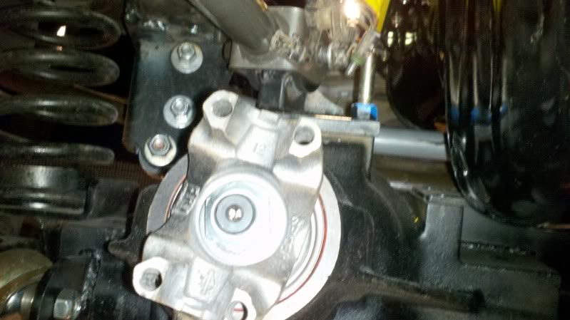

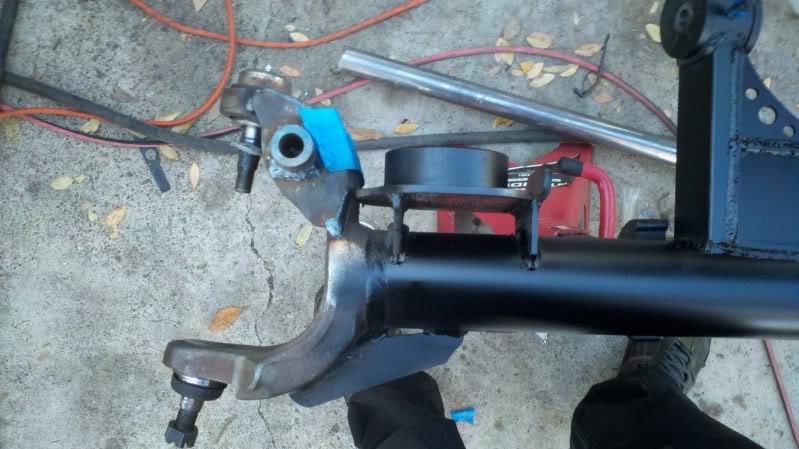

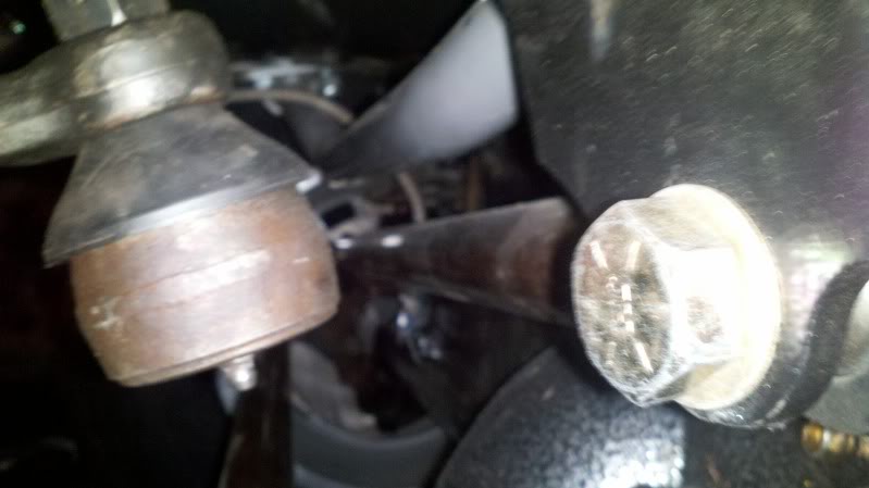

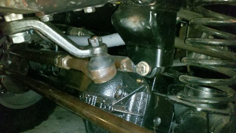

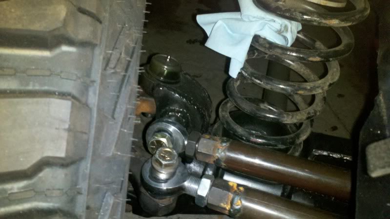

1) 2" wide JJ's won't hold up very well to the abuse we're going to put down.
2) JJ's won't deflect very well, and we're running 4 link + panhard.
If this was a 3 link, JJ's or a rod end would make more sense.
It does. Mounted single sheer with a 7.5" long 3/4" grade 8 bolt.
I can't say that its entirely our idea. I had considered something like this a few years ago but wasn't really sure if I could make it work.
Blaine @ Black Magic Brakes has done this a few times and urged us to give it a try. I am really happy that we listened to him.
