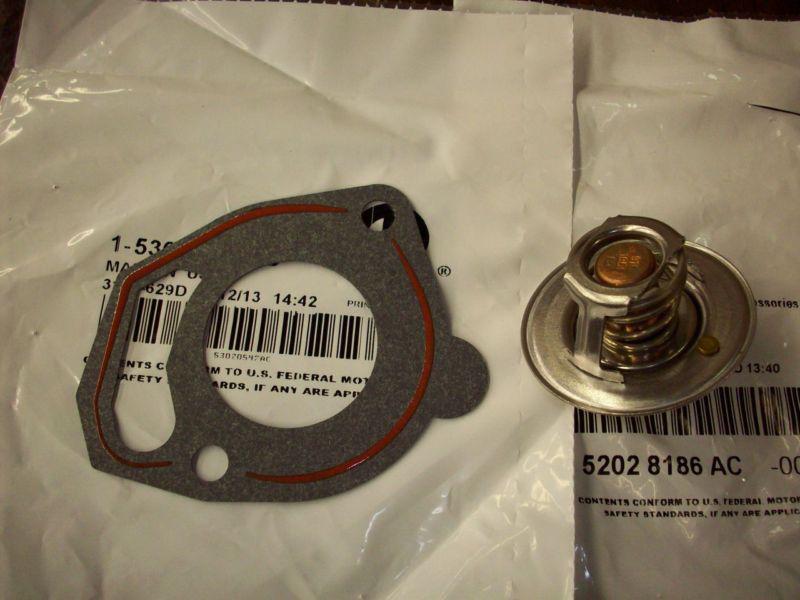

Yahoo! I replaced the thermostat last night and found an aftermarket thermostat without the little air hole at the top. I replaced it with Mopar Part #52028186AC with the gasket Part #53020547AC put it all back together and took it for a test run!
I can now run 100-120 with AC on full blast and not overheat in the Arizona summer heat! I will keep testing it out this weekend and let you know how it goes. On Monday I am going to cut the hood install the Napier Hood Vents. Now I just have to get a new Speedo Cluster and switch to Miles Per Hour!

Not sure why the little hole would cause overheating. Its there to help bleed air out of the system.
The factory Mopar thermostats have a little hole at the top to help bleed air out of the pressurized side of the system. Overall, I think it was just a bad thermostat. I didn't find any junk lodged in it, I just think it was a cheap Chinese unit.
Do you see that little brass circle on the edge of the thermostat? It is the air bleeder. Some guys just drill a hole in the cheap thermostats that don't come with them. Everything that I read on the internet about the XJ said to use factory parts and not cheap aftermarket parts.
