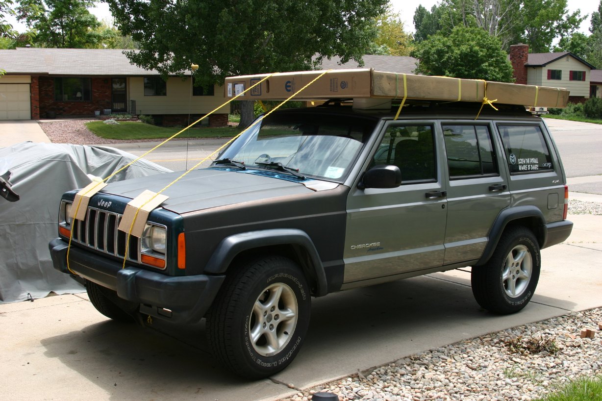

It all started with my first Freedom that I bought when it was just a year old with 22k miles on it for $4700: (drove it for awhile then sold for profit)

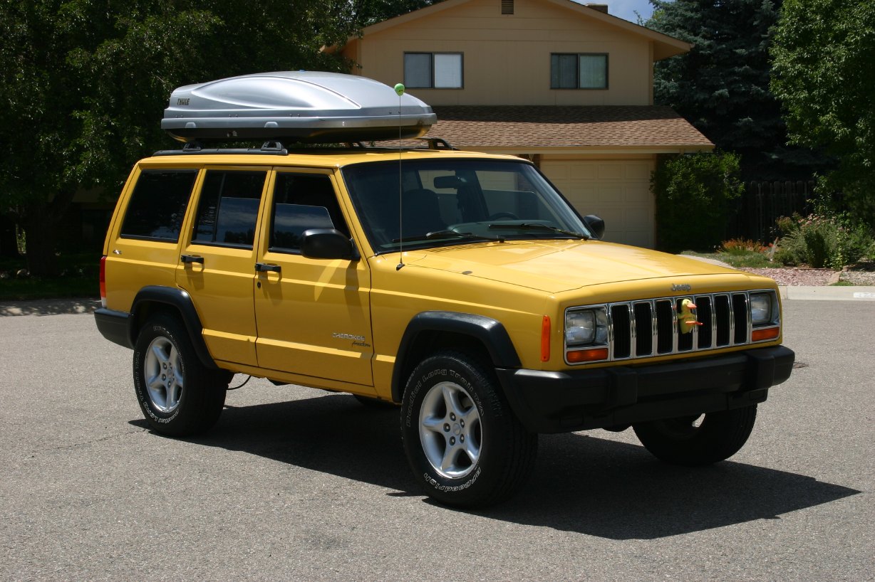

Then some years later I got that grey freedom and drove it for awhile then once again sold for profit:
