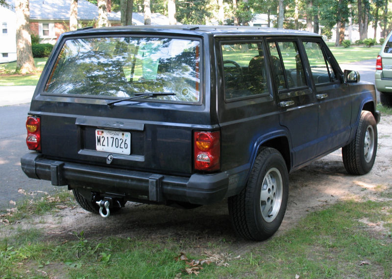

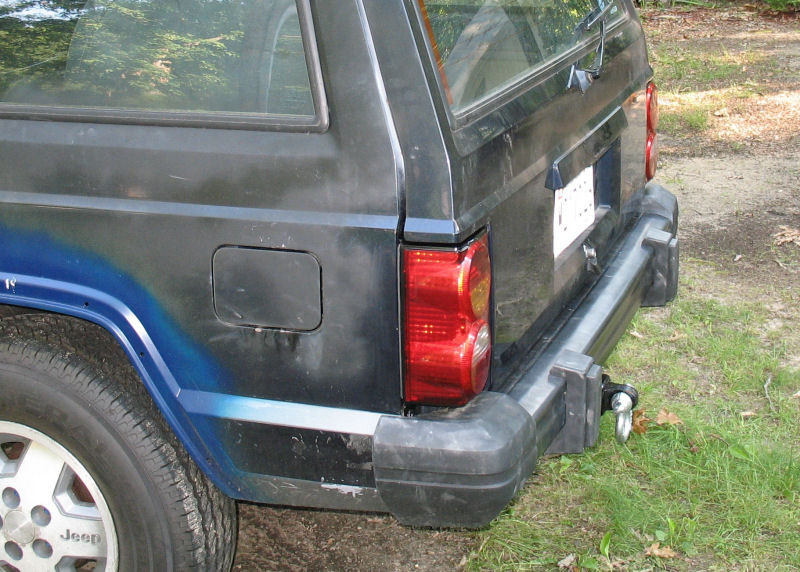

I got the tail-lights in today and installed them real quick. First the pics, then a few thoughts about them:
Production quality is not very good. I had to use a couple of small files to get the sockets cleaned up enough to get the bulb housings in. The left side housing does not line up with the screw holes in the rear body either. Also it looks like the molded pieces are separating, so they might need to be reassembled and re-glued.
Fitment is not perfect but is not bad either. I have about 1-1.5" of gap below it, and maybe an extra .25" gap on top but it's not really noticeable with my midnight blue Jeep. The upside is that they stick out further, and I have to keep my hatch a little more open than normal so that works out.
They look interesting enough. I haven't decided if I like them or dislike them.
I think the best fix for the bottom light on my '91 is going to be to split off the 1157 park/brake bulb and run a second set at the bottom. I will probably switch these and the turn indicator bulbs to hi-count LED replacements to keep from overloading the circuit.
The individual lamp housings are all enclosed, and there is almost no sideways lighting. In the interest of safety, I might drill and file mounting holes in the side of the upper lamp housing to place the little 194 bulb in the same spot as it is on my '91. FWIW I'm going to guess that the housings are not DOT compliant. I'm no stickler for the regs, but the absence of side lighting might matter.
I will order a second set if I keep them. I don't want to smash one up on the trail and have to wait 4 months for a replacement.
I wonder if the 2500 rear bumper closes that bottom gap. It wouldn't surprise me if it did.
Yeah just like mine:
http://www.naxja.org/forum/showpost.php?p=243941273&postcount=531
Muad'Dib said:
OH BTW!!!!
The sockets are a pain to get into the taillights. I had to grab a sharp model knife to "carve/finesse" the area in the lights where the sockets go. The socket hole itself was manufactured very poorly :p ... but you can get it to work just don't expect them to go right in and turn to lock.
Im betting thats why the gap is there as well .. i have yet to try the weather stripping.. but im sure it will fill in the gap just fine and look ok.
One other observation after some night-time examination: the amber lenses don't provide very much filtering power, and white/clear bulbs in those sockets will be as white and bright as backup lights. You really need amber bulbs in those sockets to get a non-blinding amber light out of them.
Don't you WANT to be one of those annoying people who's tail lights/blinkers BLIND the poor sap sitting behind him at night? LOL Some of those blinding tail light configurations really piss me off when I am behind them! Thanks for sharing all the notes on your conversions, guys! That is really helpful to those of us who are still in the ordering process!
X2 on that amber .. just installed on my MJ and after shaving some casing parts and custom fitting them ( by the way they are an inch wider for MJ ) u need amber bulbs, and some of the lighting for the lower park / stop tends to light thru the reverse lens ,, at least on mine .
Just don't expect Hella lens in these babies....:doh:
I would try a red bulb for the red lights too.. Then they won't be as bright, and if any light does bleed through, at least it won't show white light to the traffic behind you.
