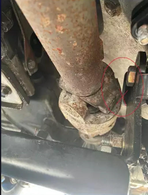

I just installed an IRO 3 link kit and the driver side arm mount is just barely rubbing against the driveshaft. I found some old threads about this but couldn't actually find a solution or fix.
The easiest would be to fab a new arm for clearance. A pic would be nice to see what your dealing with!
I will try to get a picture, it rubs just enough that it only rubs every turn of the driveshaft. I honestly have to drop it again because I messed up the caster angle so I may as well try fixing that and grinding down the bracket a bit.
Pictures work great. You can download Tapatalk and upload them from your phone.
t7j3RdY
Not a very good pic, but everything looks like there is clearance except the unknown part we can't see well.
Here's madmachinerys pic.
Looks like its barrely touching. Flap disc on a grinder should easily fix that.
The issue was the trans mount. I was using a bullet proof poly mount and apparently that was slightly bigger than the stock mount causing it to interfere. The poly mount also gave me bad vibrations, kinda disappointed I spent the money on the mounts but the jeep runs fine now. I used Anchor 2625. The lift also feels great and not much different than stock on the street.
