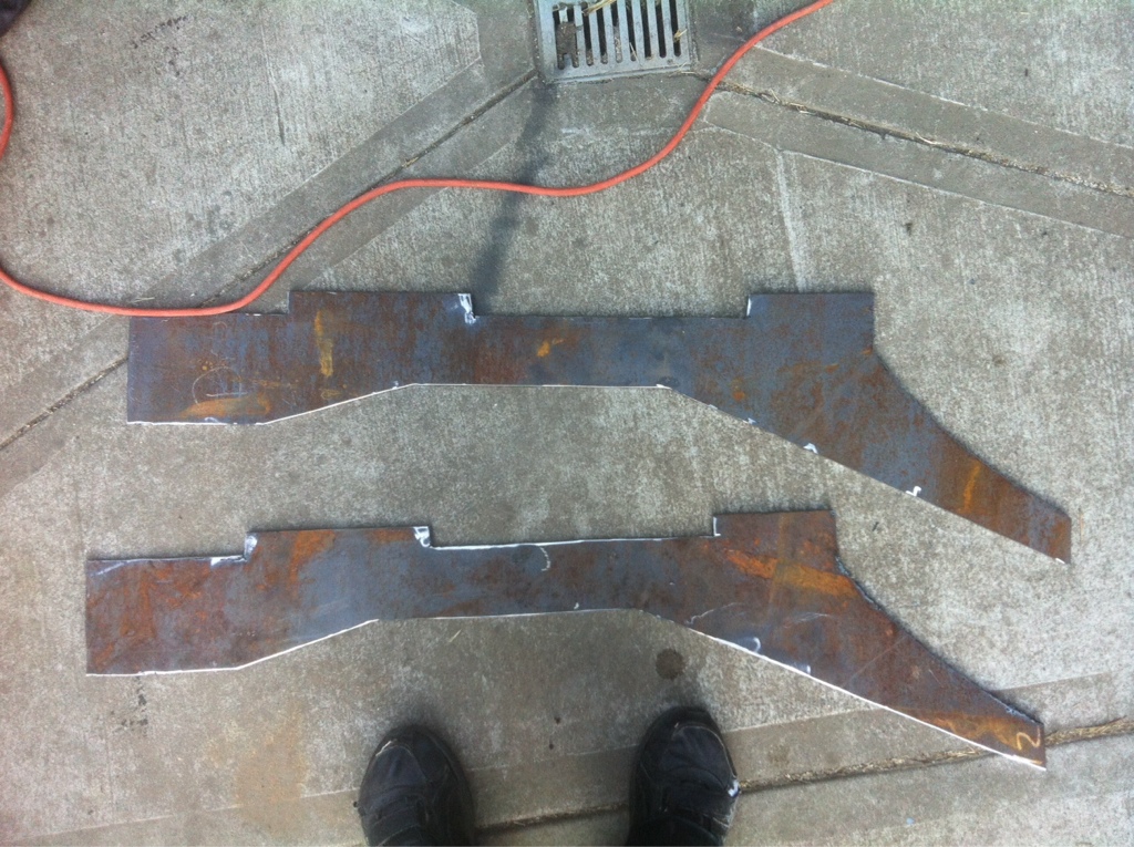

I'm in the process of making front uniframe stiffeners, 3/16" steel
Now I've been practicing welding 3/16" on to sheet metal to prepare for this task and I'm pretty sure I got it down but I do have a few questions to ask.
1. Has anyone done this with flux core? I'm using .030 Lincoln flux core wire, but my welder does have hook up for gas shielding.
2. I've also read about dual shielding, should I fill my tank for this task? And should I use straight co2 for deeper penetration or do mix?
3. Or should I run standard wire and gas?

75/25 mix is fine, drill some holes in the stiffeners for rossete welds.

co2 aint bad, but 75/25 is great. No idea what dual shielding is, but its not needed. Dont over think this.

Dual shielding wire was designed for in shop production welding of large steel structures, vessels, ship building...etc. The flux'd wire allows quicker and easier out of position welding (vertical/overhead), while the gas increases penetration while also cutting down on spatter. It has nothing to do with wind resistance.
In all honesty though, there is no real reason for the average hobbyist welder to be using it. The fumes are fairly toxic, and the regular flux core/mig wire will be more than enough.
fwiw, I worked in a structural steel shop for several years using both mig and dual shield. We wouldn't use dual shield (specifically Lincolns ultracore) on anything less than 3/8" plate.
Might as well be asking about spray transfer and autogenous welding.... those have just as much to do with mig welding frame reinforcements on... Get out of the welding books.
There is no "deep" in 14 guage ...You don't need to worry about burning in deep when your base metal thickness are 14g unirail and the very edges of 3/'16th plate ...welding to the edges of something like plate steel leaves very little place for the heat you put in to go so melting the base metal is very easy with a very little machine a 90 amp hobo freight unit will be able to blow through that .
