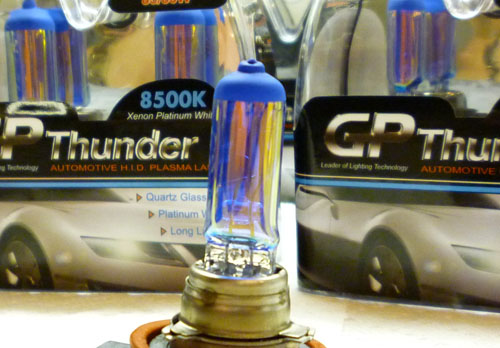

No, a 8500k 100/90w bulb will suck.
1) true 8500k is so blue/purple that it will significantly reduce contrast and lumen output
2) that cute blue/purple look also increases glare
3) that colored coating (filter) over the bulb that creates the cute blue/purple also reduces lumens.
So in the end you will have a very blue and dim light.
:laugh2: (n)
Do yourself a favor and use a quality un coated bulb.
:laugh2: (n)
those are the "new" GP thunders. the old GP thunders that I ordered are clear and not color coated.
