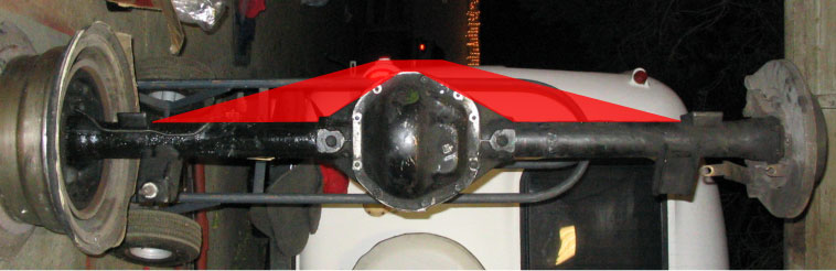

First our friend the XJ LP 44.
I'm thinking a simple over the top truss. I would imagine that it should be boxed (U channel type gig) but what material should I use? Let me know your thoughts on box vs. flat vs. I.
Here is the design:

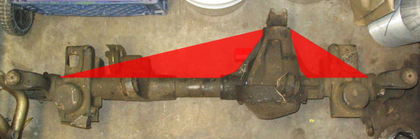

Now for the 30.
First off there's the simple top truss. Here I'm thinking flat with a possible I type ridge at the top for strength if necessary, what material should I use?
I'm also thinking of adding an additional rear truss to limit fore/aft flexing and just strengthen it more. This is the main reason that I'm thinking of going with a flat or I type truss instead of boxed as this will be extra strength.
I also plan to gusset the C's and weld the tubes.
Obviously these designs are not firm, I will be deviating from them for little realities such as suspension linkages.
These axles will be in my Cherokee and will see rock service with 4.88's and ARB's. I have no intentions of going above 33" tires for this Cherokee but would like to overbuild as much as I can.
Here is the design:
Now for the 30.
