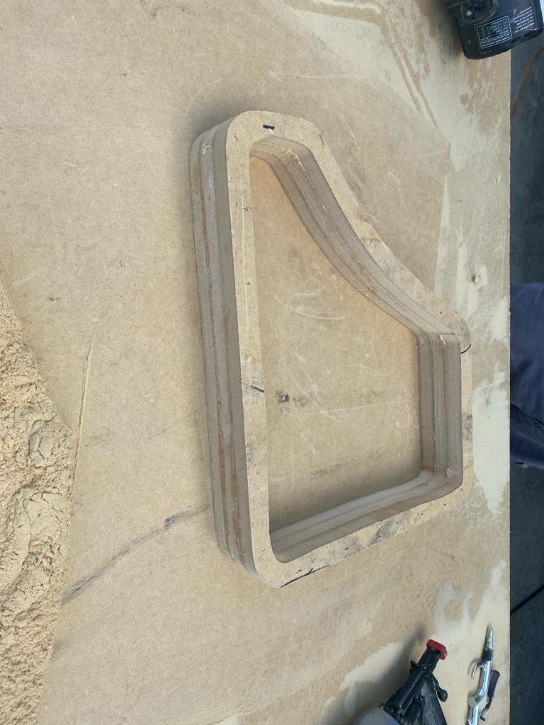

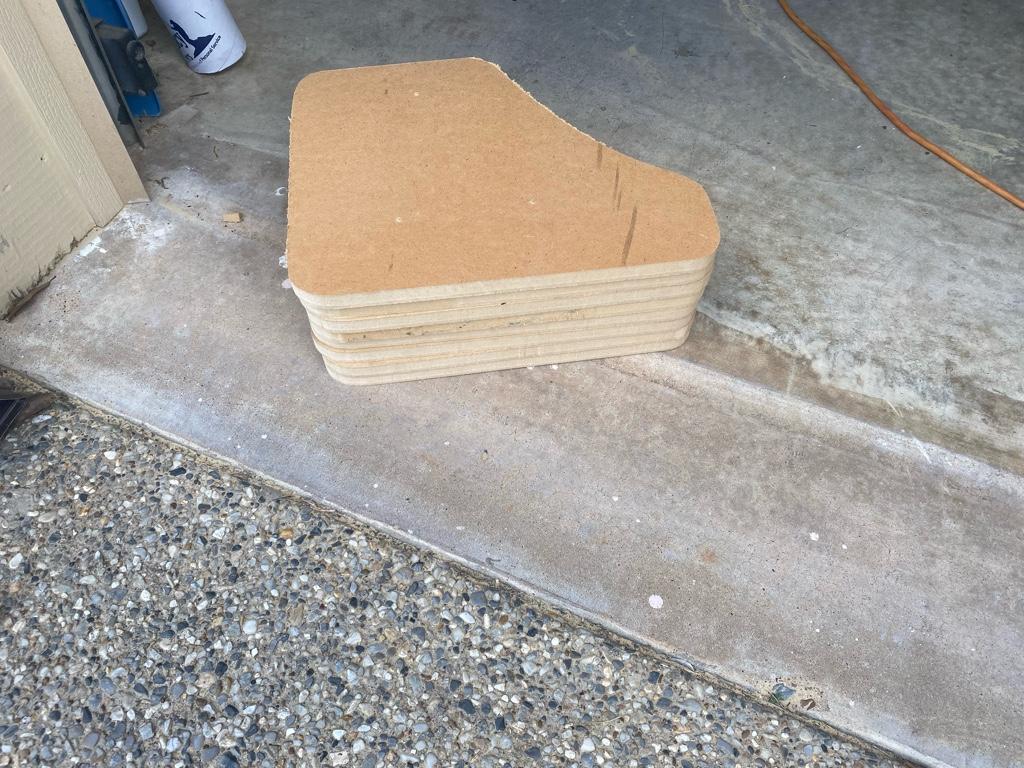

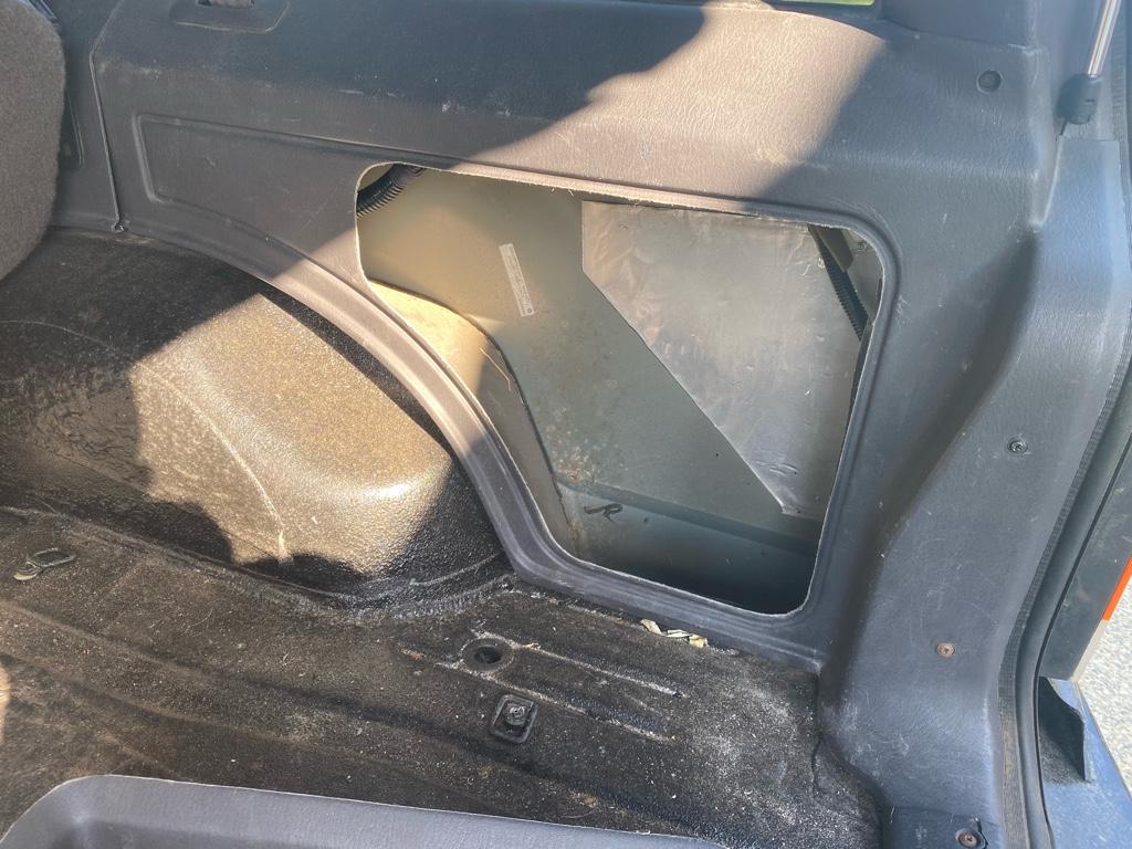

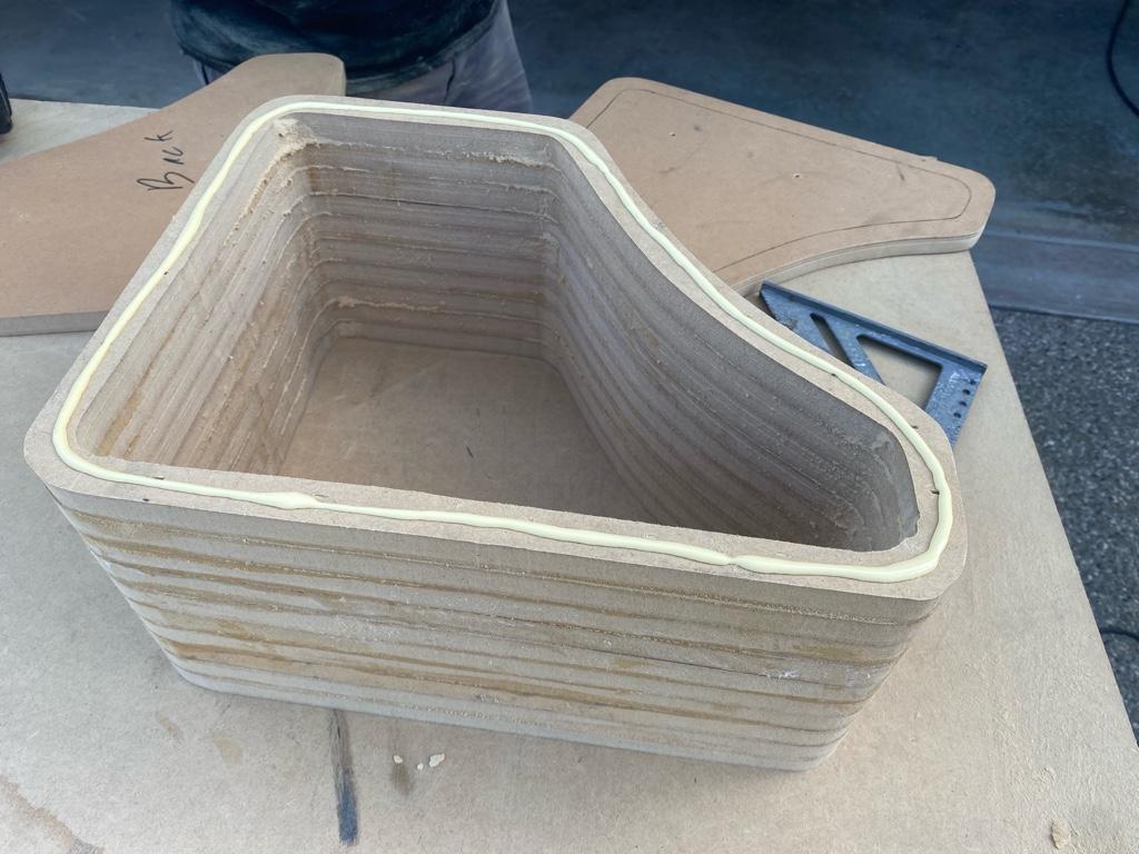

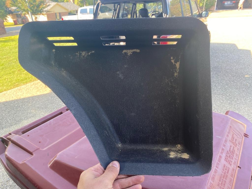

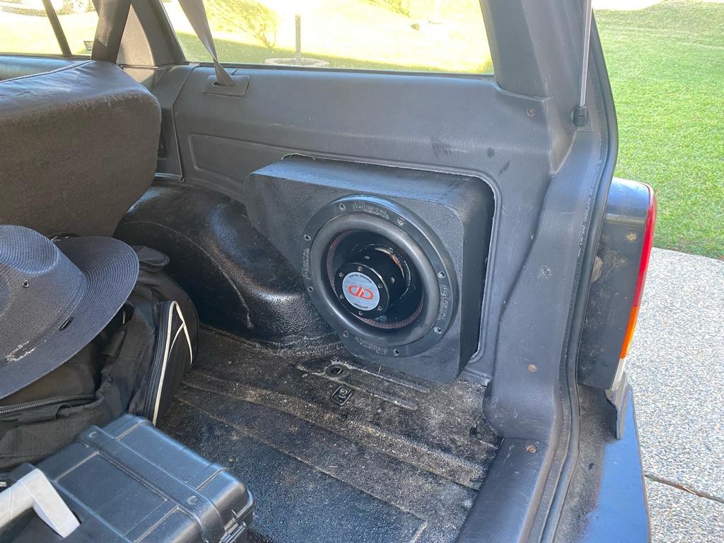

Hey guys I figured I would share my sub box I built over the weekend. I got tired of my big box for my 12” sub taking space so decided to build one in the useless cubby space. I didn’t take a ton of pictures but here is what I did take. Made it out of 3/4 MDF and graced it out of the cubby I cut out. Cut the template with a jigsaw then used a router to make copies to stack. Then cut the inner hole and routed the copies again. I prefer this method so I could keep the curve without using fiberglass although it is wasteful with wood. Mounted it to the pinch welds behind the panel and the seatbelt bracket. Thanks for looking!
