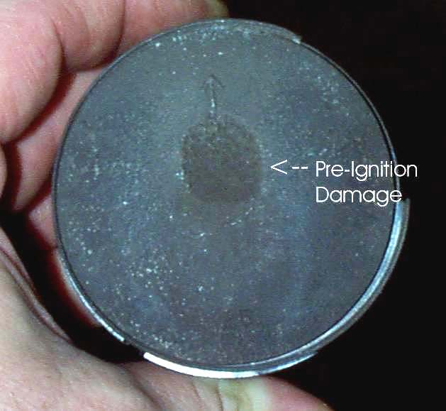

To answer my own question, a plug that is too hot can help set up pre-ignition, which raises cylinder temperatures. There is more than one variable to the condition, and not wanting to change the other variables makes switching to colder plugs attractive.
8Mud described the effects of detonation, I'll go one step further:
I like this picture because they include the plug, which shows material transfer caused by detonation.

The crux of my post is, WHAT DO YOUR PLUGS LOOK LIKE?
