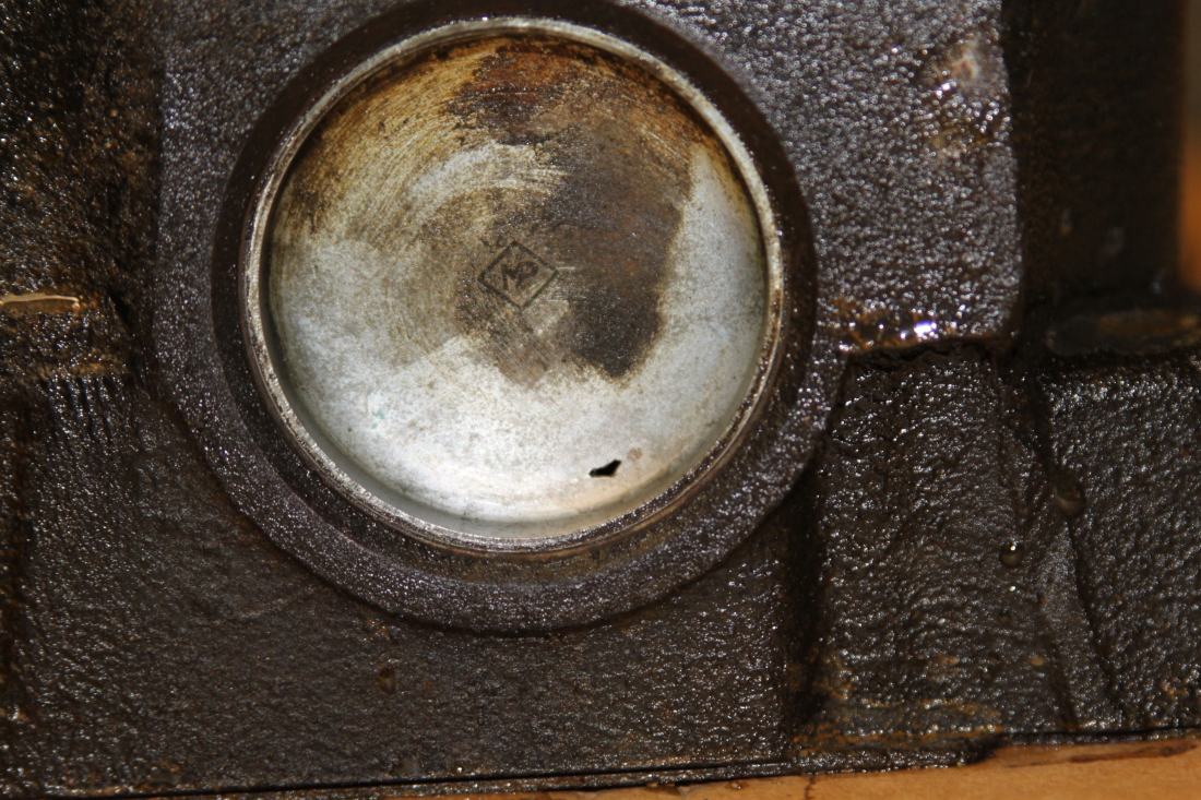

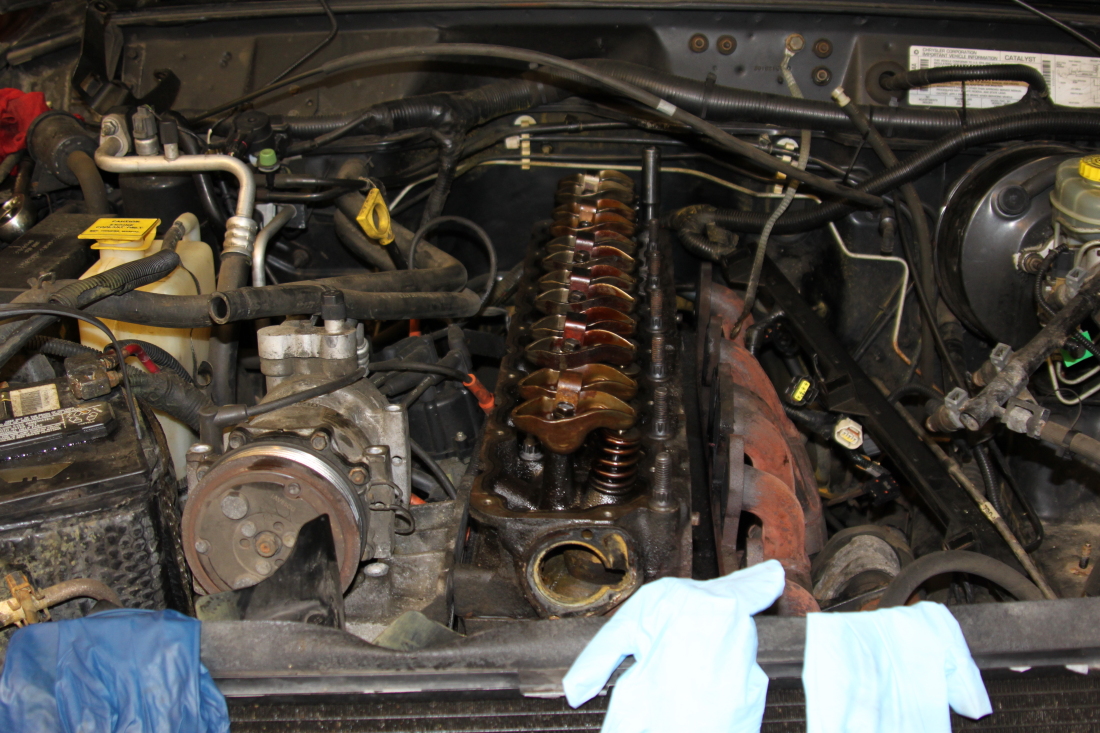

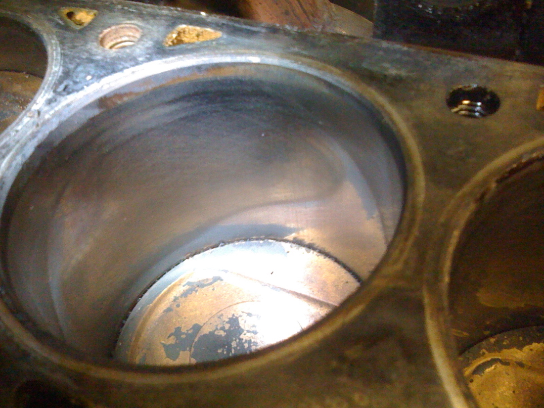

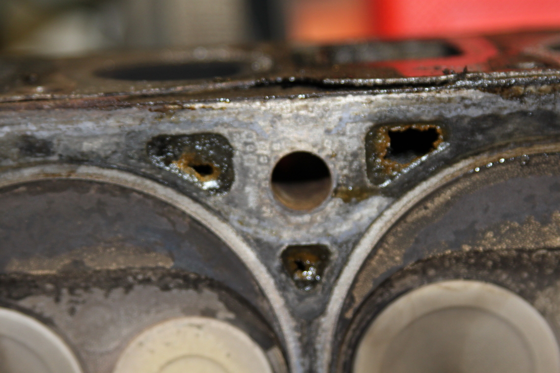

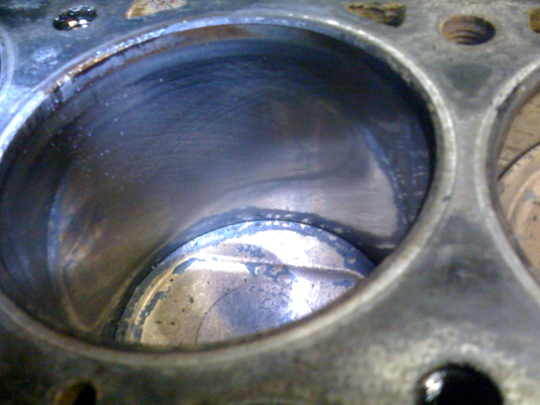

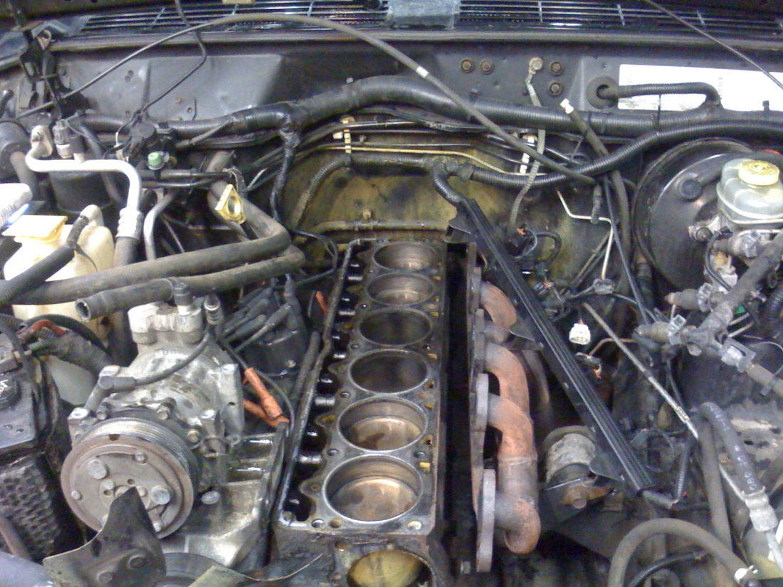

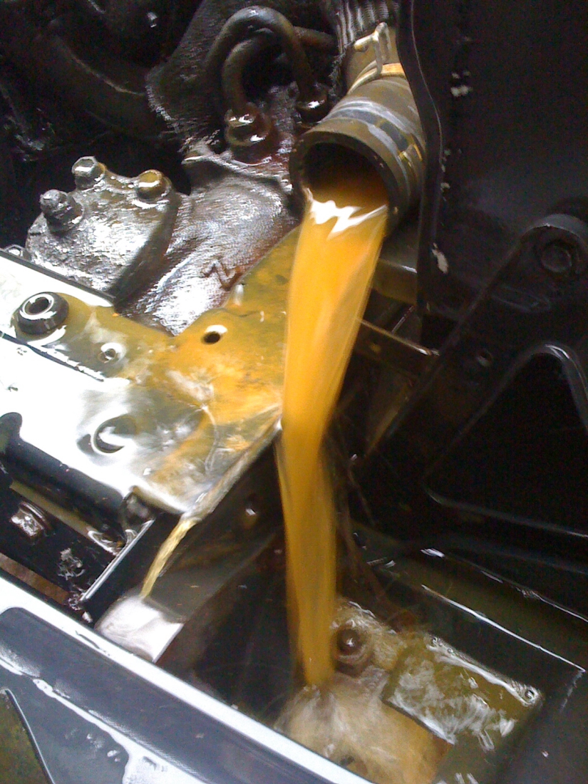

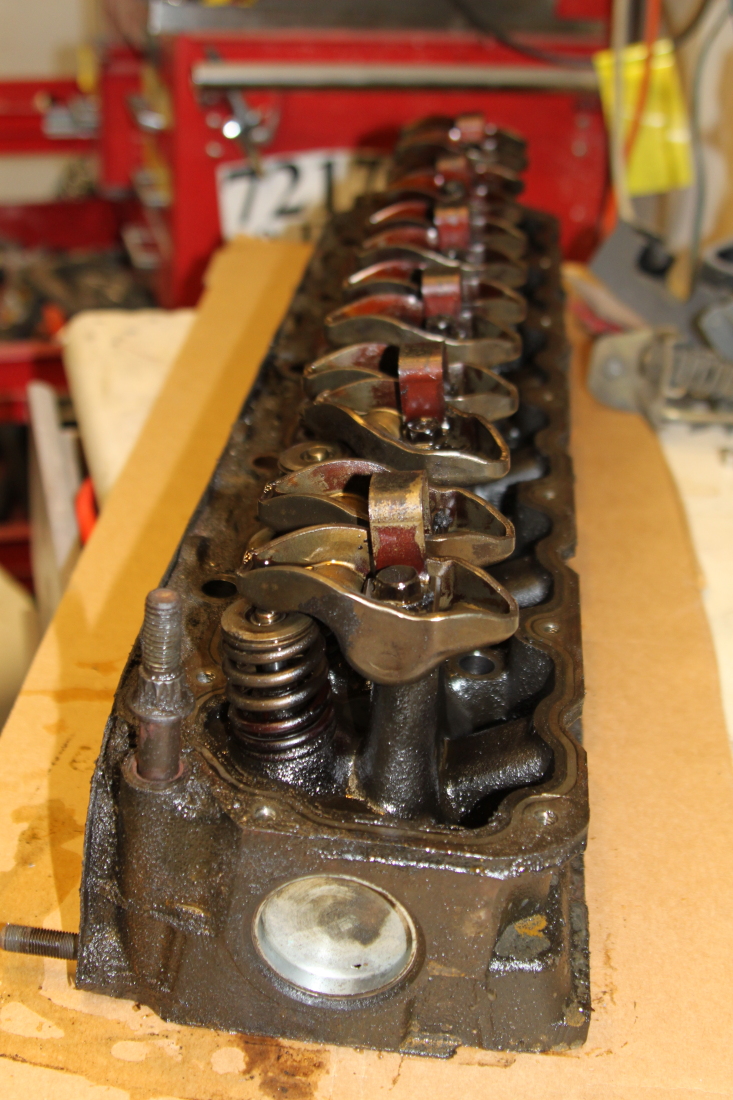

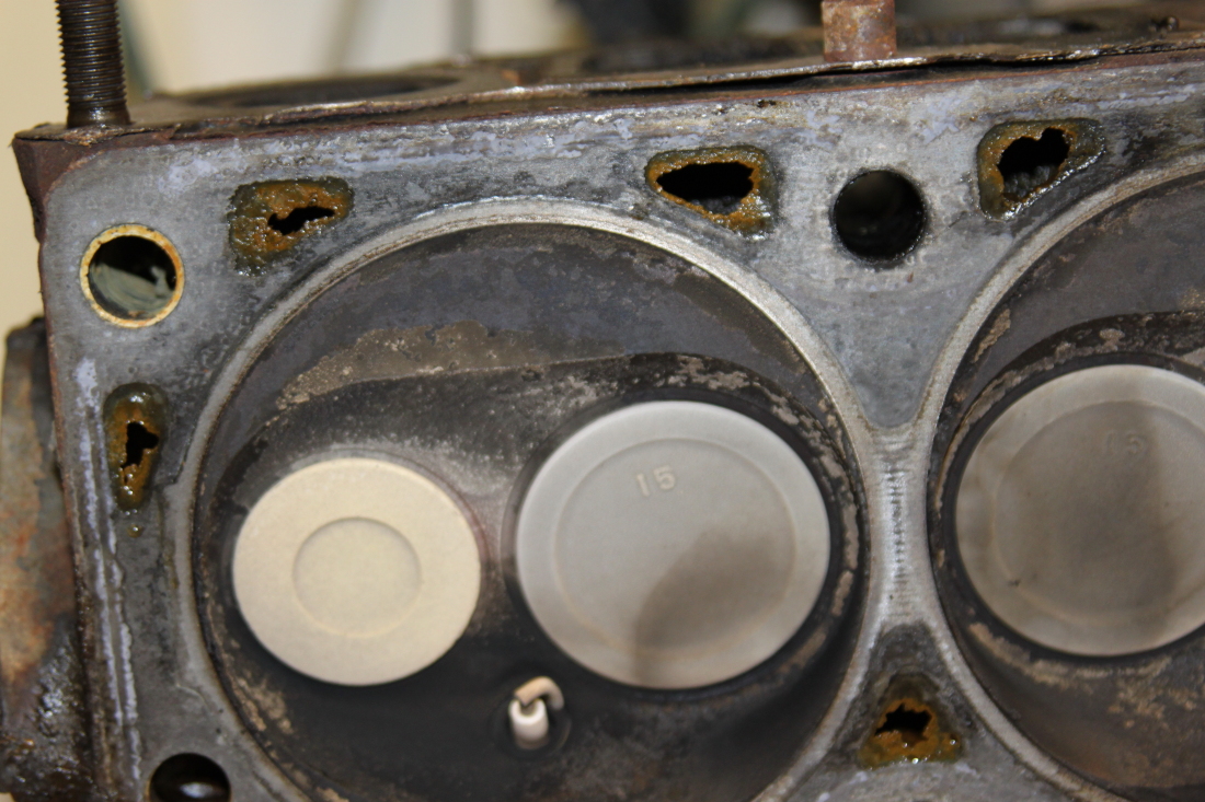

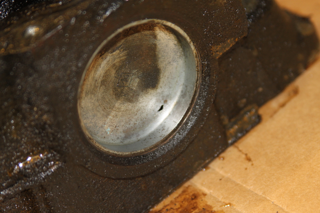

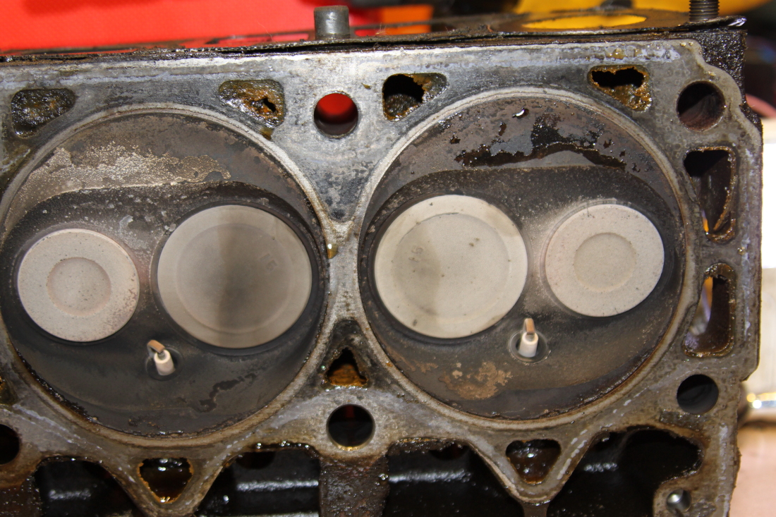

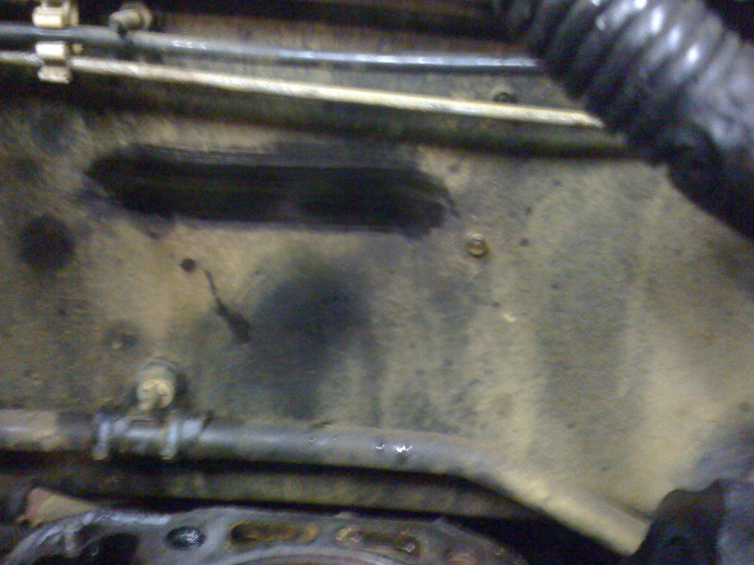

The "head gasket" issue was just a freeze plug that had a hole corroded in it from a neglected cooling system.

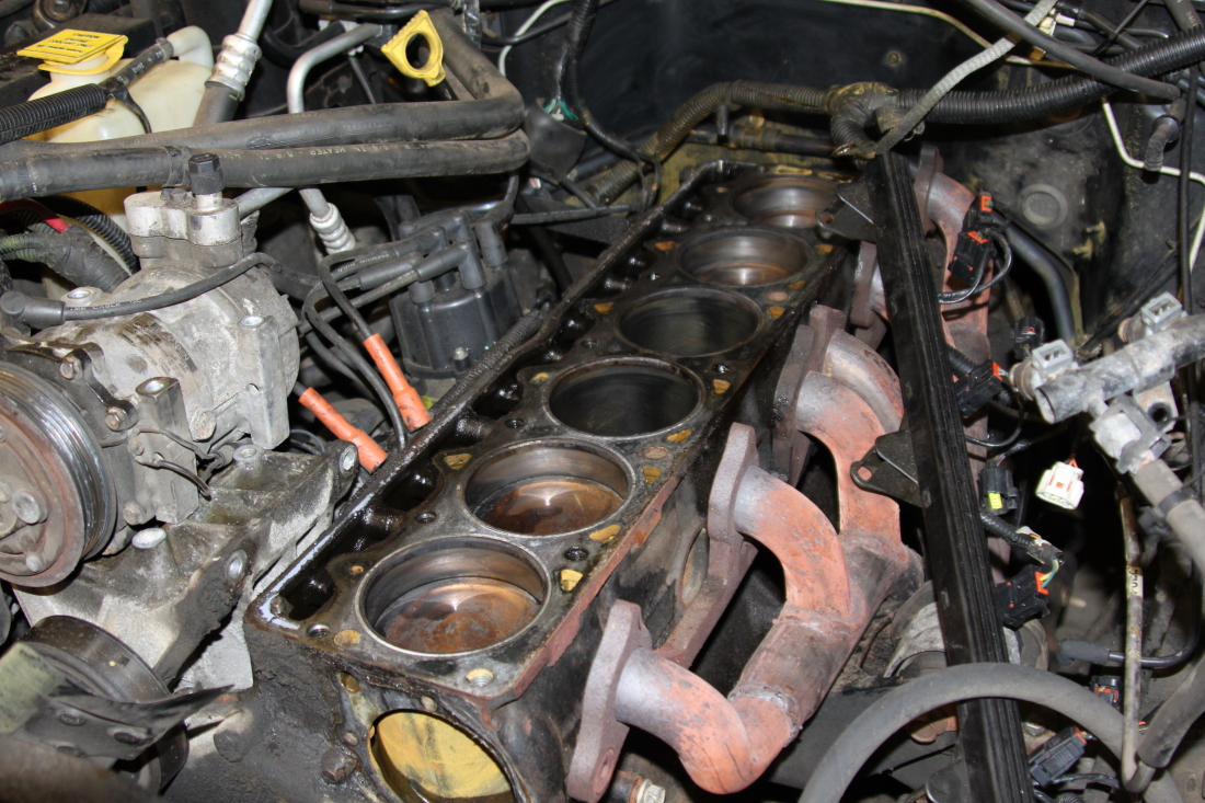

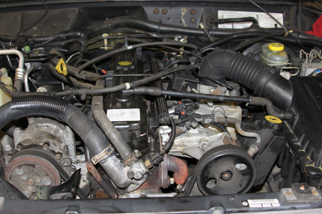

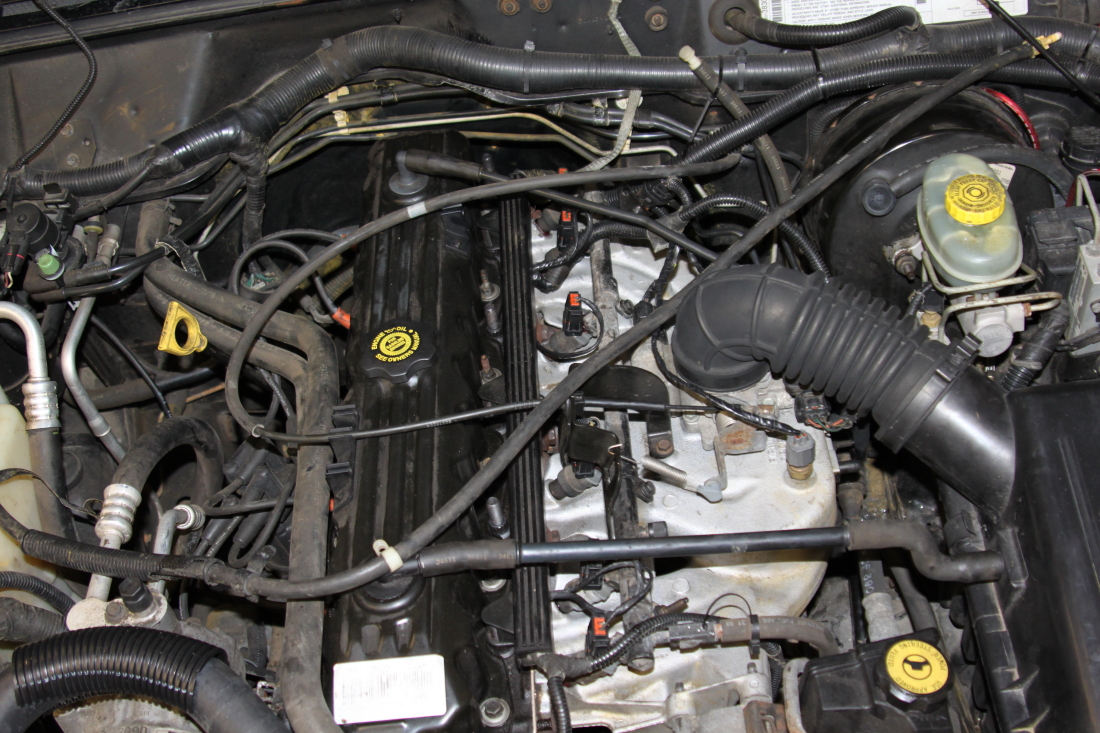

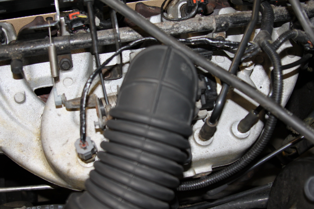

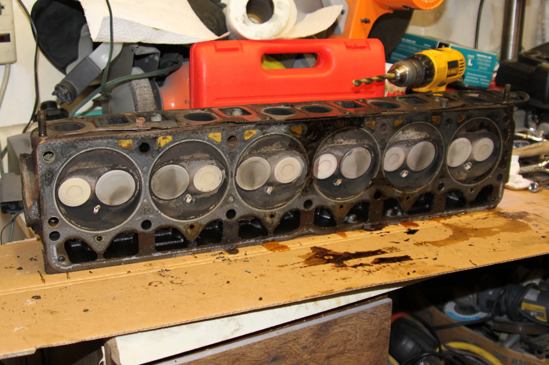

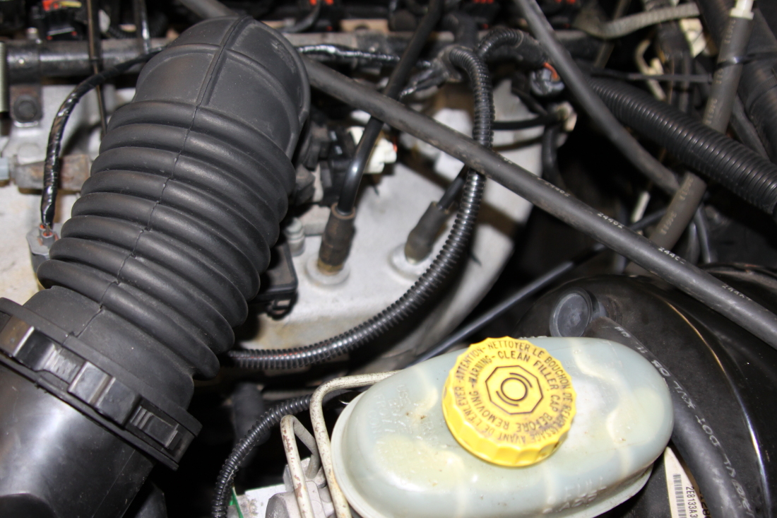

So once we got it home (whole nother FUN story in itself)...work began. Got the freeze plug replaced, as well as threw in a gasket it (head gasket, exhaust/intake gasket, throttle body gasket, fuel injector o-rings, and so on from a kit).
So whats been done:
-New Radiator, well dang close to new
-New water pump
-New T-stat
-New Radiator Hoses
-New Head Gasket
-New Exhaust/Intake Gasket
-New Throttle Body Intake
-Upgraded intake manifold to the '99 and up manifold
-New Freeze Plug
-New Spark Plug Wires
-Oil Change

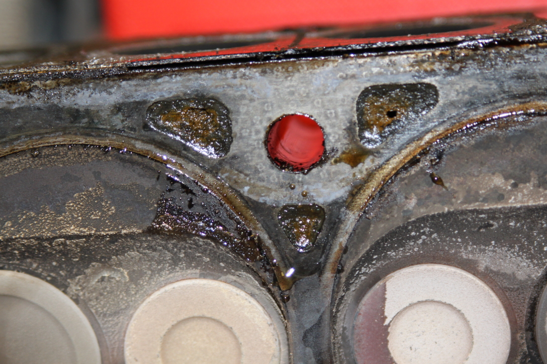

that's some tasty looking sludge in the water jacket :puke:

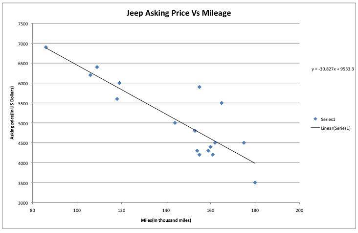

The used market is not representative of KBB either, I recently sold a white freedom, BBV was like $2600, I got $3600 out of it, and I think I was priced on the low end, I pulled data from CL denver for all the private party sales of stock XJs, plotted them, and then ran a linear regression to come up with an equation for what I thought the Jeep should be worth.
The regression showed that I should price it asking wise at $4100, assuming everyone talks somebody down by $500 this is right on with what I got out of it.
Graph:
Point being, used values are up from where they were a few years ago, I think CFC has something to do with it, I think more people are holding onto their used cars instead of buying new, which means there are fewer used cars going on the market, which is driving up the prices of used cars. All in all a changing time in the business.
