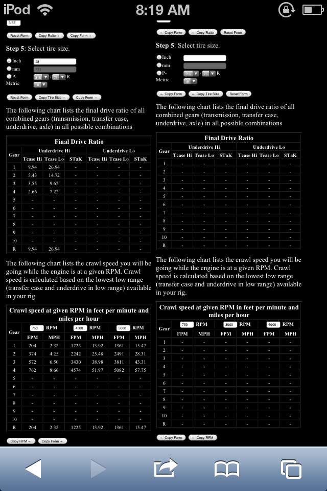

Doesn't sound sketchy at all, sound about right for it, remember this vehicle came with 28" tires and 3.55 gears.. Hell you got it better that your higher speed at 4500rpm than the stock does
This is where it's Rpms and speed is for the factory size

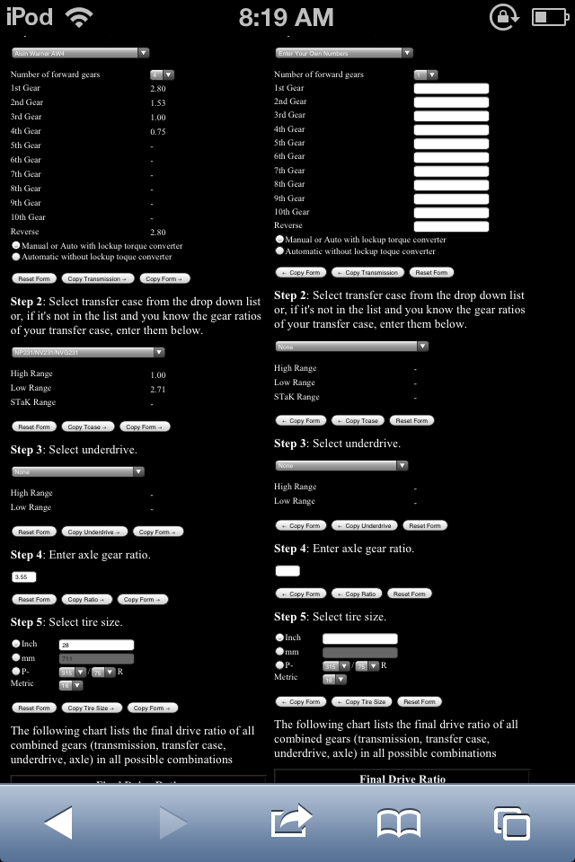

your chart is wrong. stock tires and gearing dont turn 4500 RPM at just over 50 mph. I think you might have done 4.56s on 28" tire. Stock 3.55 and 28" tire would be turning about 1600 RPM with an AW4 at that speed, not 4500. Hell, even in second gear it would only turn 3300 RPM at 51 MPH.

your chart is wrong. stock tires and gearing dont turn 4500 RPM at just over 50 mph. I think you might have done 4.56s on 28" tire. Stock 3.55 and 28" tire would be turning about 1600 RPM with an AW4 at that speed, not 4500. Hell, even in second gear it would only turn 3300 RPM at 51 MPH.:
Actually you're wrong, use the calculator yourself and you'll get the same answer as me.
Plus dont you think if I had typed in 4.56(which you say you have yourself) wouldn't the Rpms be MUCH MUCH higher than yours on 33" and 4.56 gears........ Just saying
There is a reason why so many threads state that 4.56 and 33" are close to be the same as stock gearing and tires...
you would have realized something was up with your calculator if you had just though about that. When the jeep was stock, did it hit redline in 4th gear before 70 MPH?
4.56
