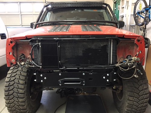

Originally Posted by Anak View Post
Next step is to mount the winch in the Comp Mount. I knew I needed to rotate the gear box 180 degrees. Warn has a brief note about this very thing right here:
Link: https://www.warn.com/blog/2011/09/27...b_bumper.shtml
And because links seem to go dead over time, the text of that reads as follows:
To make the clutch handle easily accessible, stand the winch up on end so the housing is straight up in the air. Next, remove the 10 screws from the end housing then you can lift the winch up about a 1/4" and rotate it every two holes to the desired position. Reinstall the screws and you are done.
I tried to rotate my M8000 180 degrees but there was a slight gap (about 1mm) between the ring gear and drum support when the screws aligned. My winch is brand new so the gaskets were not torn. If I took out the screws and turned the ring gear slightly it would seat tightly against the Drum Support but then the screws wouldn't align again.
I completely removed the Ring Gear to see why it wouldn't seat with the Drum Support. What I found was The Ring Gear teeth align to fixed raised teeth in the Drum Support. Noticed the gear teeth next to the ten screw holes adjacent to the Ring Gear had a repeating pattern every two holes.
Then I re-read this from the Warn web site:
Therefore the Free-spool lever can be turned every 72 degrees which doesn't compute to 180 degrees. Positions would be, 0, 72, 144, 216, & 288 degrees.I wrote Warn Industries to ask what specific damage could result if I left it at 180 degree but sealed the gap.
Hear is the reply:
"I cannot recommend leaving a gap there sir. If rotation of the winch housing is needed to fit in a particular bumper then you have the option of every other hole. It would also viod the warranty if the winch were to malfunction." MK
Of course Warn took the easy route answering my question but those teeth in the Drum Support were engineered to carry the rotational load not the ten screws.
Curious if anyone has had any issues with winch damage or water infiltration clocking 180 degrees not every 72 Degrees (star pattern).
Just to be clear. I really like the design of the comp mount and mounting the winch in the same direction of the pull. Winch free-spool clocking to 180 degrees isn't a game changer for me. I'm just making sure I don't cause a problem down the road when I need to rely on the winch.

Now that I have the new selector piece from Bryson (absolutely beautiful machining btw) that winch is back up on my priority list.
I will clean everything up inside and see what there is to see with the aligning of all the important bits inside.
That gap you see in that picture is not entirely a conclusion. Knowing that I was waiting on new gaskets I did not bother to do anything about the old ones. In some places the gasket stuck to one side, in others it stuck to the other side. What you see is the thickness of two layers of gasket in a place where there is no gasket at all. At the time I was more concerned with macro level fitment issues.

This Picture is the End Cap With the raised teeth. Notice the teeth across from the mounting holes. Red=single tooth Green double tooth.
This pattern Repeats every other hole or every 72 degrees. The Drum Support has the same raised teeth that match the Ring Gear below:
If rotated 180 degrees where the screws align through End Cap, Ring Gear, and Drum Support the teeth will not mesh interlocking and it will create a gap.
Well that blows.
Why they wouldn't just make the tooth count correspond with the hole pattern seems like dumb move.

Got the winch mounted today to see where the free spool lever will point toward the bumper. Will mount it at the 216 degree angle. This means I will need to punch a new hole in the Comp Mount and through the top of my bumper. Will also need to modify my bumper for the fair lead opening. Now that the winch is in place I can measure for new cable lengths.
Also Got the pillow block mounted. Really tightened up the steering. I can feel that it is more responsive. Had to loosen the steering box and pry on on it a little to get the pillow block on.
Before mounting the pillow block, I took a short video to see how much the steering box was flexing on the frame. Enjoy the video. https://vimeo.com/247753308
