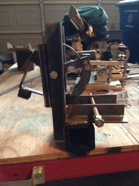

I've been approached to build several roof racks in the last week, and really wanted to be able to bend tube for a specific design I've wanted to build for a very long time (but haven't had an effective means to do so). After reading this thread, I had a Sunday funday project.

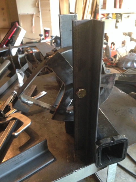

I did things a bit differently, and decided to make mine receiver mounted since I don't yet have an anchored bench in the garage, and when I do, it will have 2" receivers built into it.

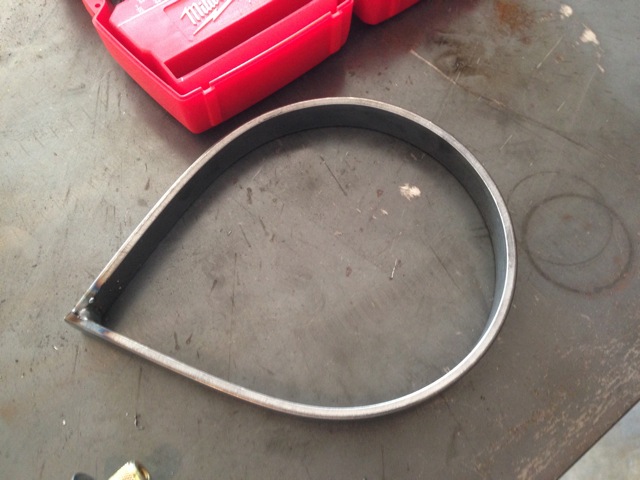

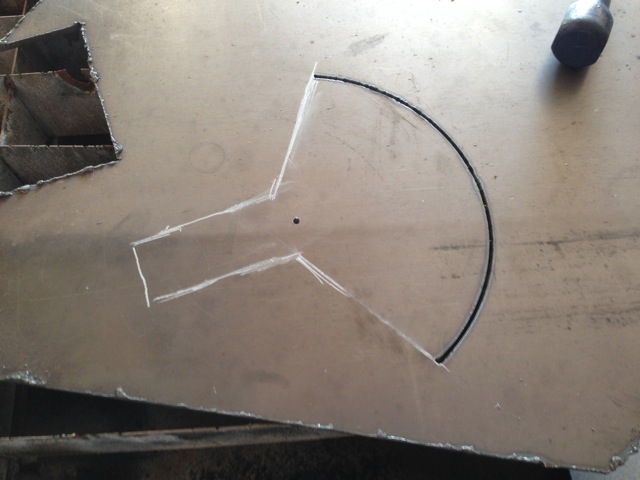

I made the die from 3/4" x 3/16" flat bar, bent around a small gas cylinder (20 cu ft).

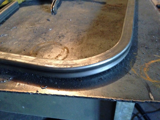

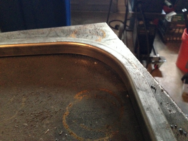

And... The result of the first bend on 14ga 3/4" tube:
Bam. No sidewall deflection. I will be adding a crush bead to the middle of the die to make bending easier, though (getting it started takes some force).

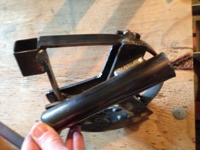

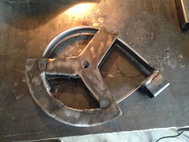

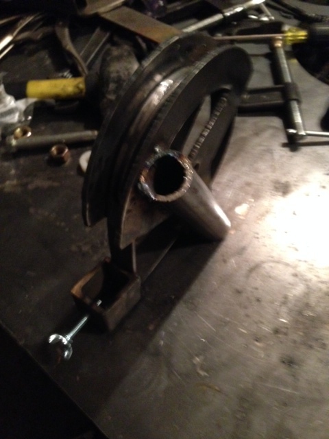

It was a hell of a fun afternoon project, and will make building these roof racks possible. I've since built a 1" die as well:
In my haste, I screwed up 2 aspects of it:

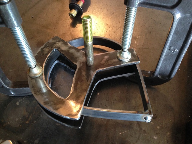

1) The teardrop piece apparently wasn't perfectly flat when I welded the ends together... So it has a slightly off-true arc. After welding the side plates on, this became apparent.
2) I welded the handle receiver tube onto the opposite side of the die. No biggie, just weird.
I did put in a 3/16" inner radius crush bead which yielded a 1/4"+ divot in the tube. I'll be building a replacement 1" die sometime over the next few days (without the crush bead) to see what difference it makes in the process.

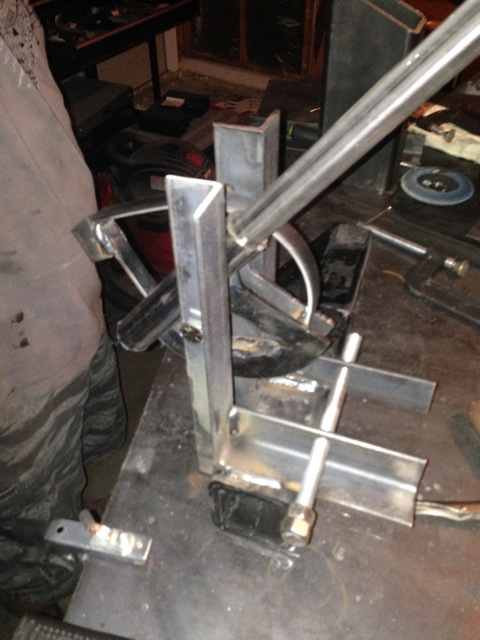

I did a large radius bender for 1" on my teardrop trailer project. It was considerably lower tech, but worked for the bending I needed to do.
Here is the result and a few more pix.
Thanks guys - I bent a few more practice pieces this weekend and found that these dies are WAY more consistent than I expected. Both the 3/4" and 1" dies yield identical bends from all angles and directions. Should make these roof racks look deceivingly "pro" :D
I also picked up a 6' digging bar, and shaved the pointed end down to a 1" diameter rod (really just had to shave the hex ridges down to a smooth cylinder). Now this thing practically bends 3/4" under its own weight.

The big weld bead is the 3/16" plate tag to hold the tube in place while bending.
