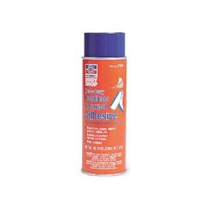

thats awesome.... where did you get your headliner material from and what adhesive did you use, im going to attempt DIY with her headliner
I used a $17 can, orange with black top, can't remember the name right now from Napa, just for headliner. I also went to Walmart and got canvas material in black, no foam, kinda like the newer cars, holds up great and I love it, just be sure to scrub all the old foam off with a brush to get a proper seal.
This stuff, Permatex
