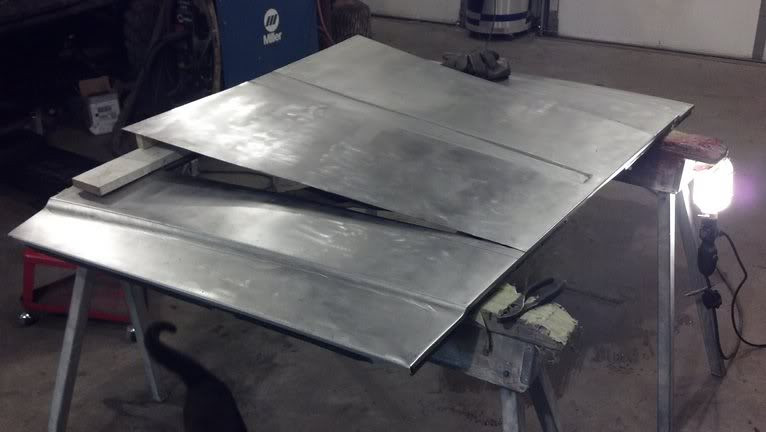

Re: Cowl hood the right way
You're both correct, sitting at idle you can feel heat being blown out of the cowl. I'm hoping it helps keep the jeep cooler as it gets warm when we start pushing some trails. It just does the opposite going down the highway, the high pressure created by the air ramming into the windshield actually pushes it into the cowl. The other day I was cruising into town and noticed a leaf stuck to the screen until I came to a stop and it blew off.
I'm new to jeeping so it hurts to put dents and scratches in the toy but we've already had it to 3 different ORV parks this year and it's got worked
Sorry I'm not interested in building any. Its pretty time conuming and would cost more than you'd want to pay but now you know how I did it!

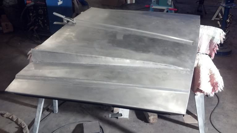

Very Very nice work. It's hard to see in the pictures but did you use metal dowels for the structural pieces? I'm assuming you removed them after you welded in the sides?

Hey Jim the "dowels" are actually 1/4" steel rod I used to form a frame to weld the cowl to. I left it all in there because the hood would be flimsy without the extra support.
