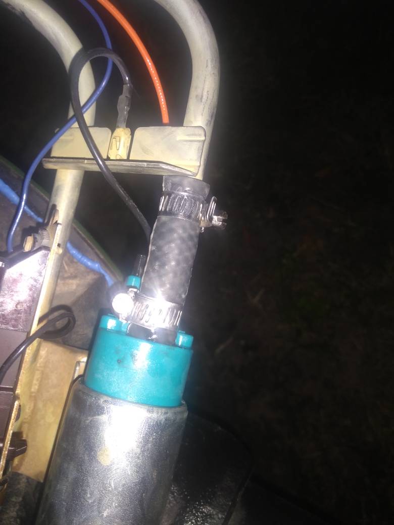

Low and behold i have progress who is still awake!? First a question... What SHOULD the system hold psi wise, and over what time period....instead of losing INSTANT pressure, it went fron 30 to 20 ish when i shut her down, than over the past half hour its down to 15... Now down to 12... I THINK it kight hold 12, ill explain what i found later on, but for now need the pressure answers please... I promise you WILL laugh ..
Sent from my Moto G (5S) Plus using Tapatalk
  #27
Old November 8th, 2017, 20:38
Intellect Intellect is offline
Join Date: Oct 2016
Location: Tampa Florida
Posts: 183

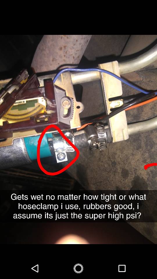

New fuel pump, new regulator, still has fuel pressure issue..
The little rubber hose at the bottom was leaking, i sat the sock filter guy in a cup of gas, ran the pump, and watched as gas trickled out of the bottom of the hose.... I added a better hose clamp and actually used two... It still lighlt lighty leaks just enough to notice its wet, is that normal? The hose and clamps are fine, and it holds 25 psi after shut down fine, than 15, than an hour later drops to 9/10 psi... SOO
, the 30psi during running to 0psi when switched off, was ALL THANKS TO A HOSE CLAMP!
IS IT ok that it SLOWLY bleeds down to 9/10psi or do i have a second issue at hand?
Should i keep buying different hose clamps till one leaks 0%? Lol

To clarify... Jeep had 30psi cranked, 0psi as soon as it was switched off.
The fuel pump in cup of gas
When cranked would leak, when switched off would leak
I put new hose clamps
Now when cranked it DRIPS ever so barely, and when switched off it leaks ZERO and pressure dies SLOWLY from 25 to 9/10 over an hour of time.

Re: New fuel pump, new regulator, still has fuel pressure issue..
The 30 psi is about right.
The leaking down is still not right. But, it is nice to see that you have made progress on that front.
A couple of details regarding that hose. First, make sure it is the correct type of hose. It should be SAE 30R10. If in doubt, you should be able to get that from a Napa auto parts (Linky: http://www.napabeltshose.com/~/media...hose.pdf?la=en )
Second, get yourself some fuel injection hose clamps. I don't know that they are generally required inside the tank, but given the situation I would not hesitate to spend the $5 or so to get the best clamp possible for the job. FI hose clamps should do a better job.
Once you have things under control at the sending unit/pump assembly, if you still have a leak down situation, then go back to clamping off the fuel line to see if you are losing pressure at the injectors.
You may have more than one issue at play here.
ETA: Thank you for posting up your progress on the problem. All too often solutions are proposed but no follow up ever happens, and thus nothing is learned by the rest of us. And I am sure it is often really simple stuff, like that leaking hose, and no one wants to share something that others might think is stupid. I am certainly not laughing at you for a leaking hose that can't be identified without taking things apart and testing them outside their normal environment. Thank you.
