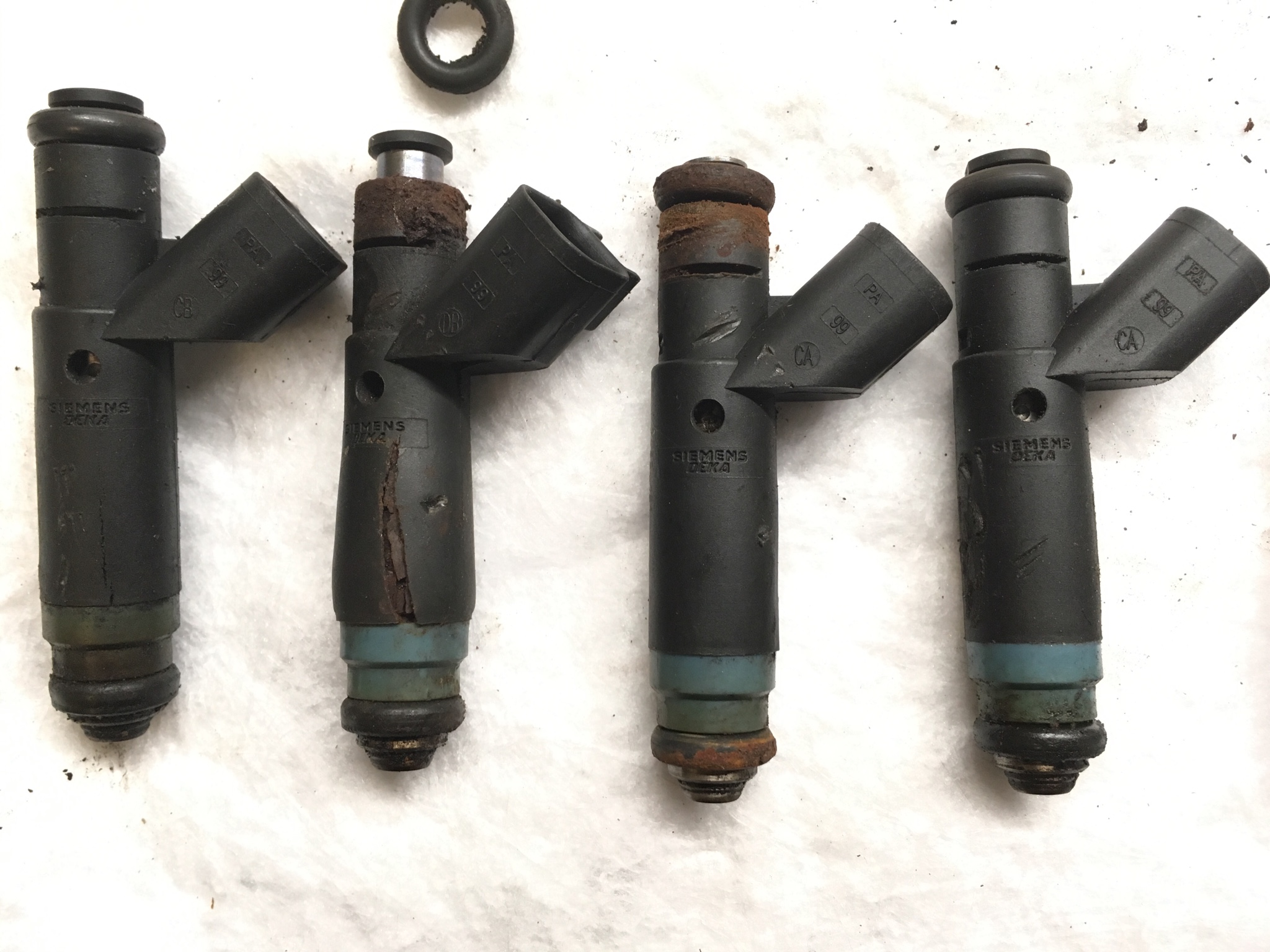

2) cracked/corroded fuel injectors - purchased these: http://m.ebay.com/itm/271530798451?_mwBanner=1

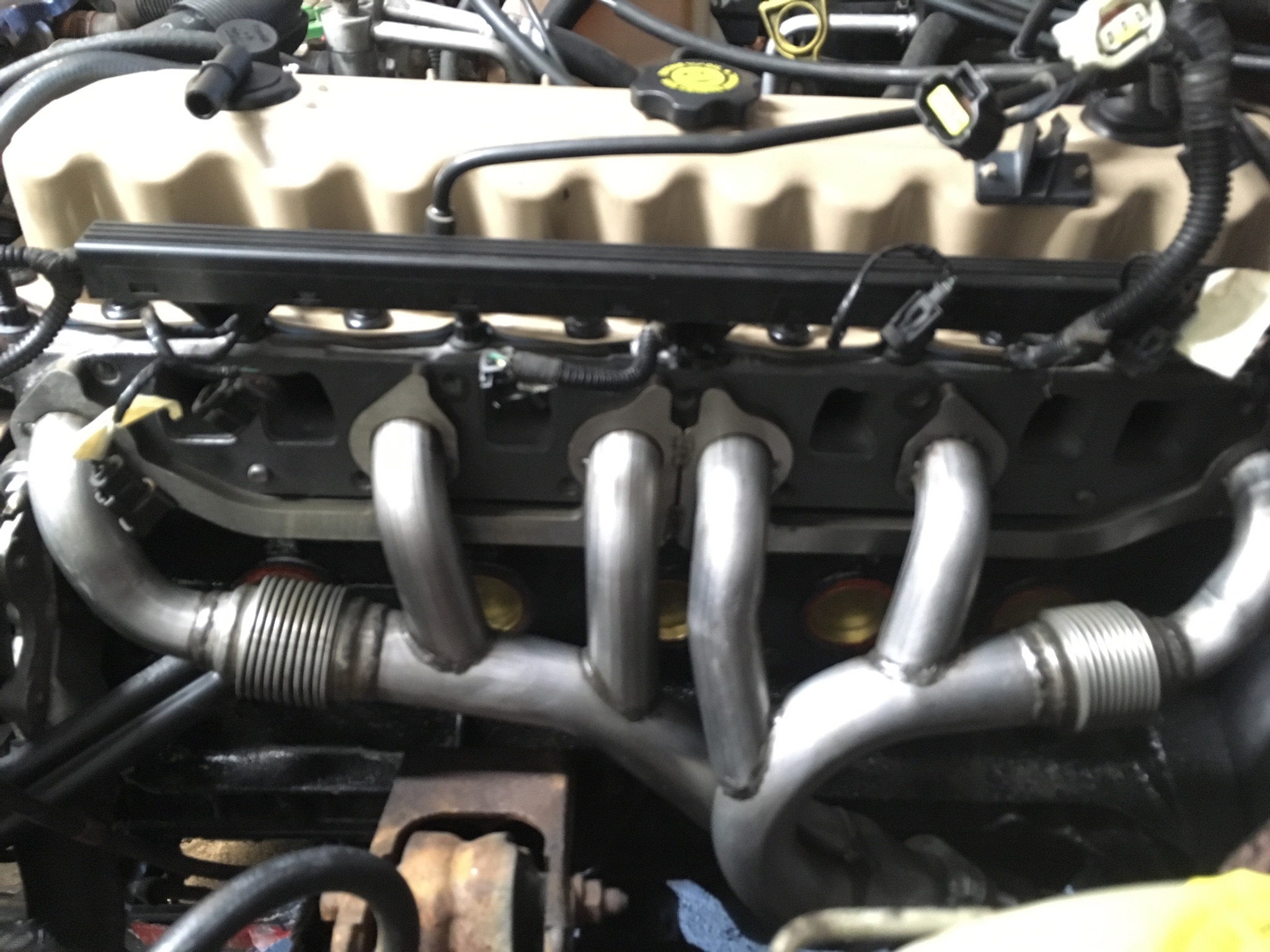

3) Exhaust manifold cracked in multiple
Places - purchased this: DNA Motoring HDS-JC9140-BK Stainless Steel Exhaust Header Manifold https://www.amazon.com/dp/B00QKJGKIQ/ref=cm_sw_r_cp_apip_i5VWULFX5P5xy
I followed the installation of everything to the T.
Installed head cylinder, new exhaust manifold (with loose down pipe), new intake manifold with new hardware.
Here's what I noticed: the exhaust manifold and the intake manifold flanges were not the same thickness.
This new exhaust manifold flanges is thinner than the stock one.
The bolts go in straight but since the flanges are different in thickness, the washers go on a little slanted.

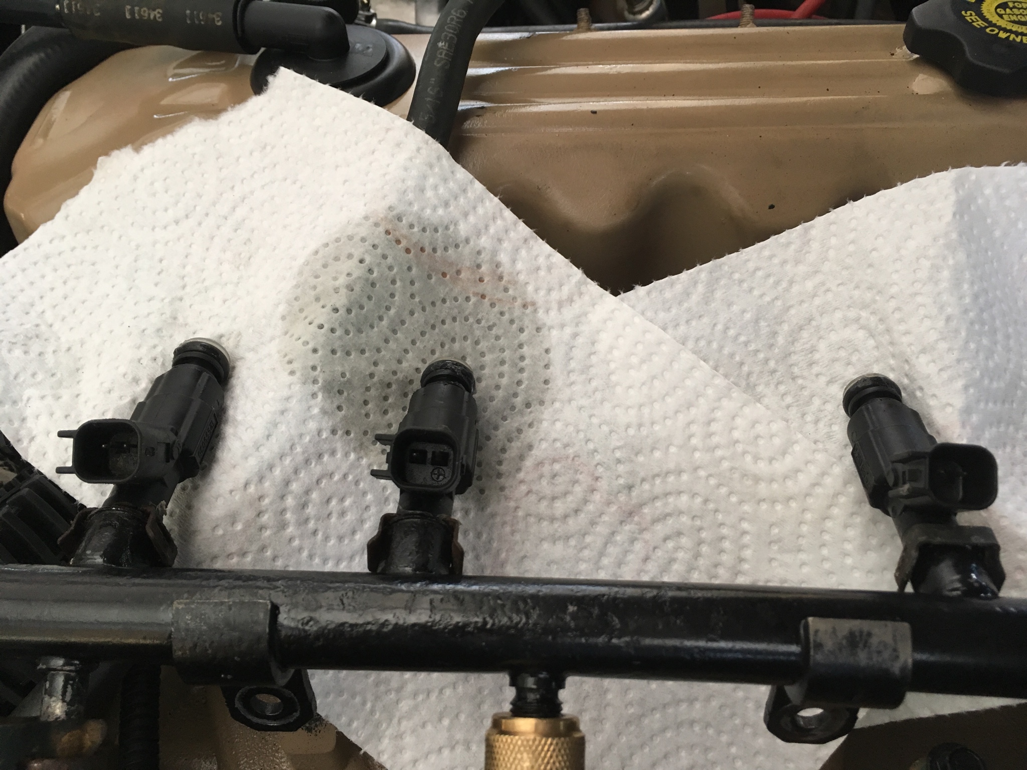

I would check the new injectors for proper sealing to, maybe re-install the factory ones. Mine are cracked, but I think that's more of a cosmetic thing.

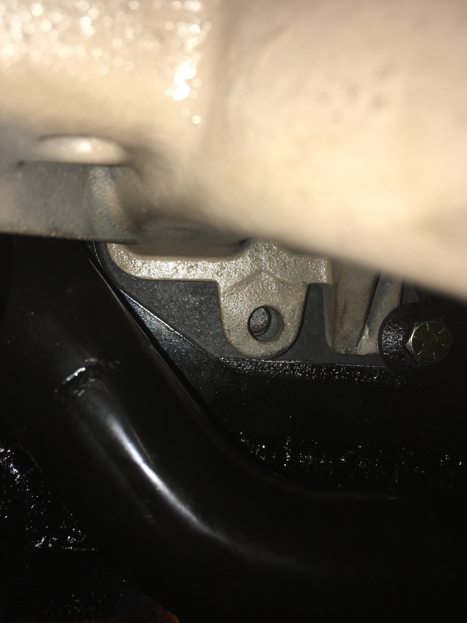

The high RPM's indicate an intake manifold leak. The manifold is likely not flat and flush to the head. Check it for flatness, and make sure it is not getting hung up on the dowels in the head.

Is it just me, or can you physically see a gap between the intake mani and the head in that picture?
Make sure the manifold isn't stuck on one of the dowels!
I see gasket between the head and manifold.
I agree, if the fit up is not perfect, it is time to "stop the job" and find out why.
This new exhaust manifold flanges is thinner than the stock one...
My question is: has anyone else ever seen such a thin aftermarket exhaust manifold flange? what would you do in my situation to fix this? Do you think the difference in thickness is causing the problem? Should I shave down the intake part?
If you have verified the difference in thickness by measuring both exhaust flanges, send that new junk back as sub-standard.

Re-reading this thread, so the exhaust is thinner than the one you removed and the intake is the same as the one you removed?
Make sure the headers aren't interfering with the intake. Installed some APN headers on a 2001 a while back and the header tube for cylinder 5 interfered with a cast "gusset" (no idea what else to call it) between runners on the intake. Had to cut some of it to clear it and get them fully seated. The thickness difference shouldn't be an issue (mine was more substantial).
Thanks! You give me hope! I'll have to really inspect everything really well.
I just went through this with DNA motorsport. I emailed them before I bought the manifold to ask what the flange thickness was. Their response was that the manufacturer didn't specify that measurement but it was guaranteed to fit all oem measurements. My DNA manifold measures 0.39" and a stock is 0.493". I'm guessing they both start out with 0.5" flange stock but grind more off to compensate for warpage. Again just a guess. I filled an informal complaint. They gave me back $20 and I got to keep their POS manifold. I contacted speed_daddy and emailed "Nikki" the customer service rep.
