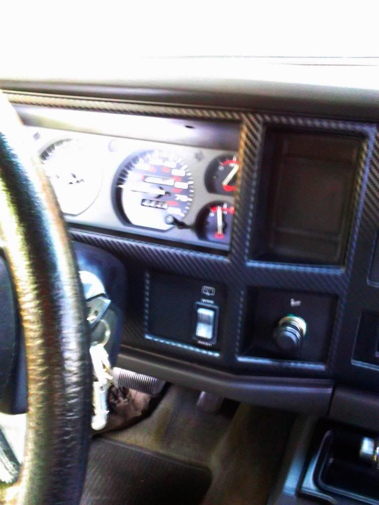

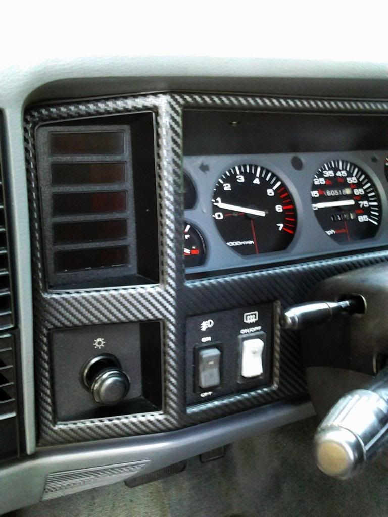

XJ Dash Customization (Carbon Fiber Look)
I dig it too! I'd love to see that done to a Limited interior so that the dash and door panel spears all get that CF treatment...... :thumbup:
Might have to consider this for my mild custom MJ's interior and find some gray Limited door panels.....
Thanks for the positive feedback guys. :) It's actually an adhesive sheet (sticker) from ebay. It looks and feels like carbon fiber. You clean the surface with alcohol then carefully stick it to the panel. Then you use a heat gun so it can really grab the panel and hug the corners. It becomes soft with heat. If there are any bubbles, you use the corner of the razer blade and poke a tiny hole. When you do that and apply heat, it goes away completely and it looks great.
