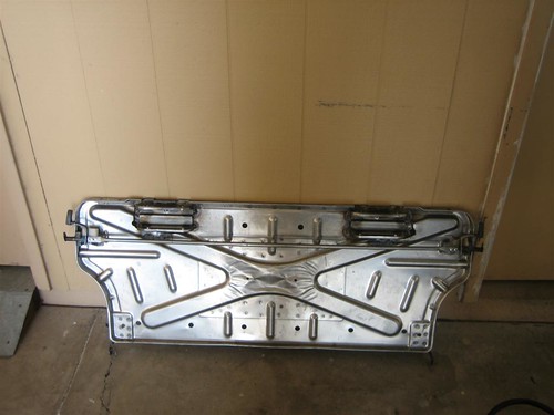

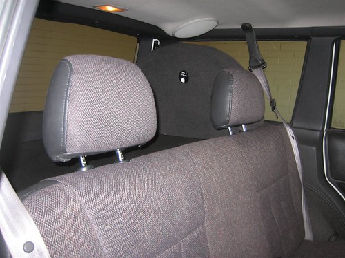

To answer the original question... I have the 90amp HF welder, and I like it. I suck at welding and this pos doesn't help. It has a 10% duty cycle which means you can weld for 1 minute and let the welder cool for another 10. This isn't that bad with the small projects that I use it for. You get a lot of spatter with flux-core. You'll want to pickup a HF grinder as well. In fact, pickup two or even three. On the first, put a flap disk. The second use a grinding wheel, and the third, a cutter. You are looking at about another $20-$30 for gloves, a cheap face mask, some magnets, and some clamps. Overall, I'm happy with the cheapo welder, but I find myself wanting to weld bigger stuff. I think it's a good thing that the welder is the limiting factor because like I said, I suck at welding.
Here are some of my HF flux-core projects...
hey i want head rests on my rear seats!!! but anyway...are you serious that you can only weld for one minute?
Yep that's right. I typically only weld for 15 seconds or so at a time, so it's not a huge problem. If I was building a bumper, that would be really annoying. If you have the money, invest in a better welder. If you are looking for something to tinker around with, you can't go wrong with the HF unit.
