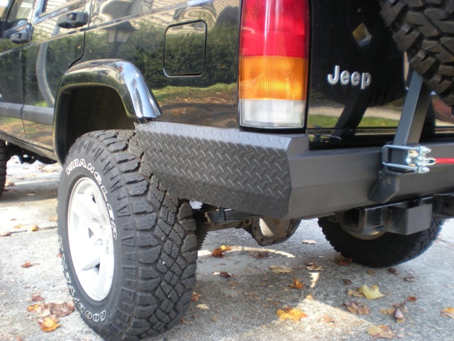

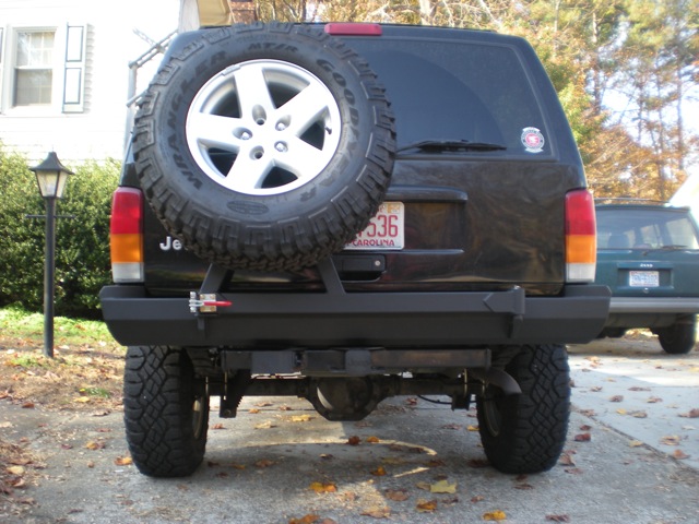

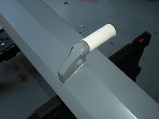

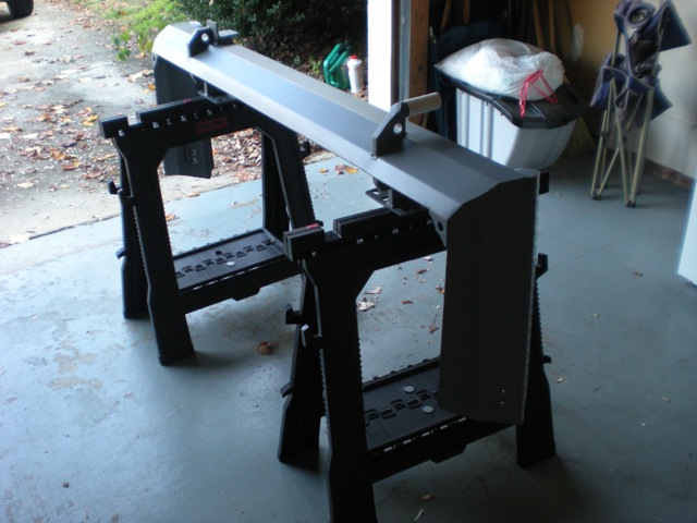

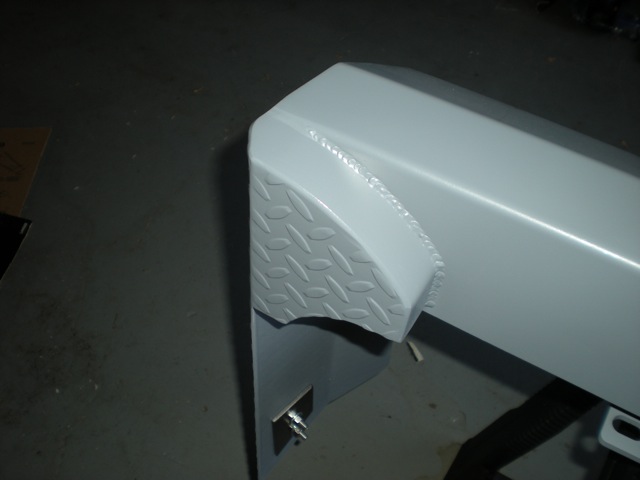

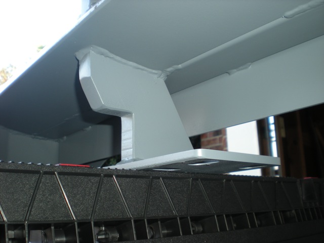

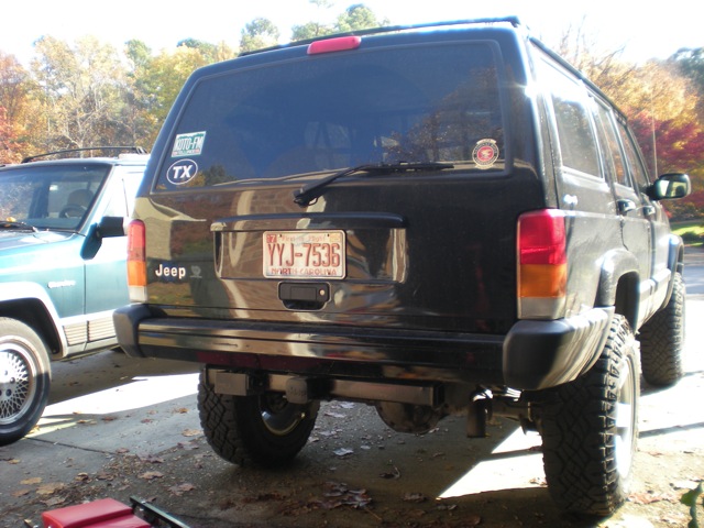

Well, my Slimline is installed... Here's a brief summary of what went on.
Arrival and unpacking:

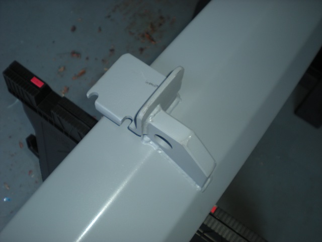

Some close-up shots of the various aspects of its construction:

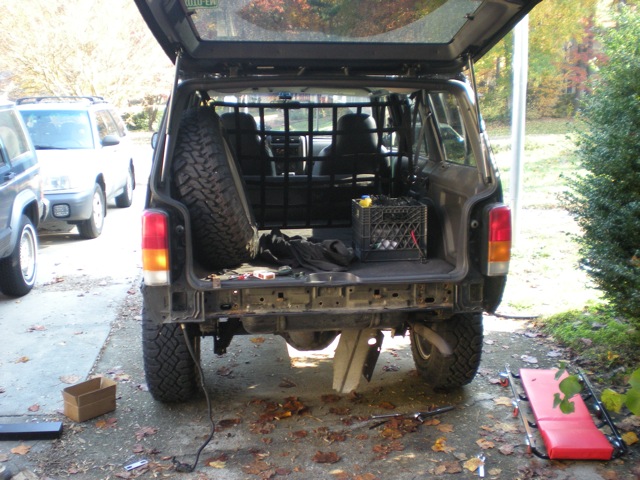

Before tearing everything apart:
Torn down:

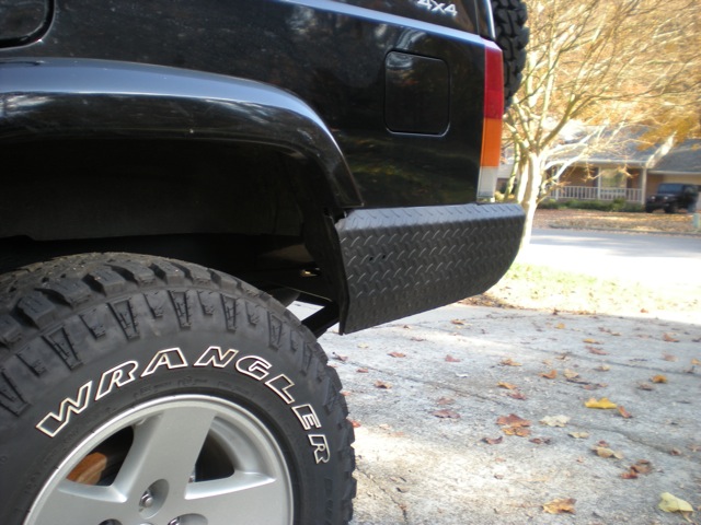

And suddenly, it was installed:
The whole bumper was painted with Rustoleum Industrial flat black rattle can paint (surprisingly cheap for such large cans, ~$5 ea).
A few notes about the installation:
  • The pieces on the rear quarter panels that are riveted to the body in order to support the stock bumper caps must be removed (not written in the instructions, but should probably have been assumed).
  • Tightening all the bolts was an unspeakable pain in the ass. Turn 4 degrees, flip the wrench over, turn another 2 degrees, flip the wrench over to the 12-point box end, turn another 2 degrees, and repeat... Over and over. This was made considerably worse by the OE hitch.
  • The factory hitch nut strips had to basically be cut in half (as only the front 2 will remain stock when taking the detours frame rail hardware into account). Cutting the strips in half and using the removed pieces to slide them all the way into place worked quite well.
  • Two new holes had to be drilled in the factory hitch in order to secure the forward bolt on the Detours frame rail bracket/hardware. Not sure if this is an issue with all hitches, but it was with mine.
  • I can't stress enough how much of a pain in the ass tightening all the bolts was.
I have yet to cut out the wheel well interior sheet metal in order to secure the side skirts, but might do that tonight (I want to find some metal stock to patch the holes once done first... Some screws and RTV would be sufficient). All in all, I'm really, really liking it.

BTW: thanks for the photos of the Slimline. I'd wondered how the hinge and latch for the tyre carrier were mounted to it, and having them up against the D-ring receivers like that is one of the smarter ideas I've seen in that area.

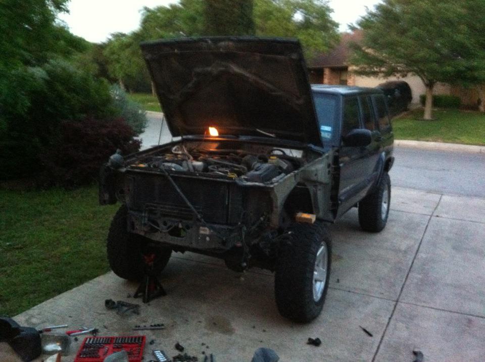

I'll start the tear-down once the new fender and grill panel arrive, as well as the Rigid FbG I have on order. The whole car is likely going to receive a Raptor Liner paintjob, which I'll detail as well.
Would love to see this. Get any veal?
Oh I'll post pictures, believe you me... I doubt I'll document the whole process given how mind-numbingly tedious prep work will be, but definitely before/after shots.
Unfortunately, the park rangers took the cow for use in bear/lion traps and whatnot... The price I pay for reporting the incident.

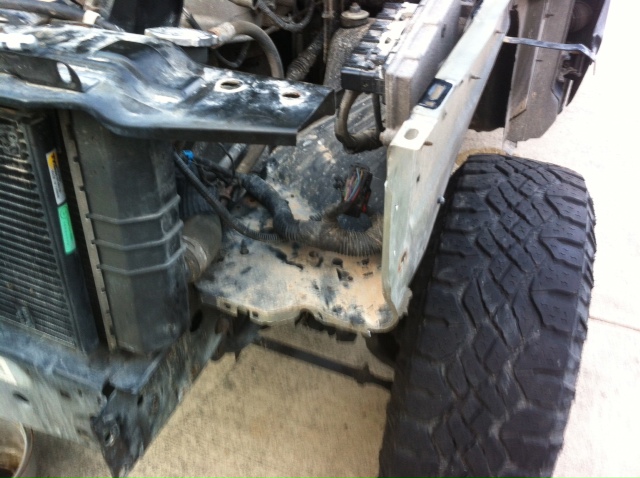

The good news is that the frame damage I experienced (where the bumper bracket punched in the frame rail) should be easy to fix, and Terry over at Rigid said it was likely that simply attaching the driver-side mounting plate will straighten it out (starting with the rearmost factory bumper mount bolt, pulling it flush with the rest of the frame rail). The bumper's not ready yet, but he offered to get the mounting system finished and shipped out in the next couple days so I can get a head-start on the body work.

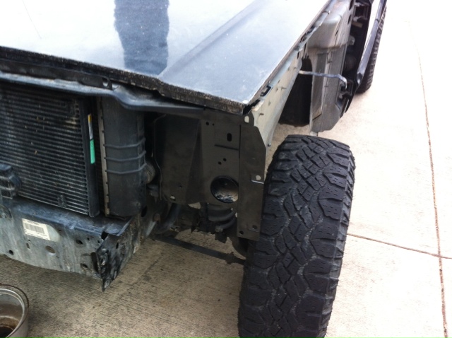

Well, there has been some progress...

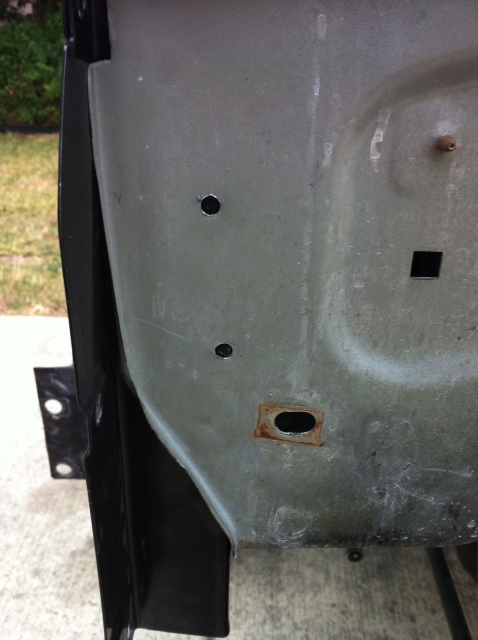

I sheared my lower steering box bolt when removing it, and found the factory spacer was seized to the steering box as a result of that, so I ordered a C-Rok spacer considering it'll be an upgrade as well. Not sure when it'll get in, but I'm hoping soon.
The radiator support baffle repair was actually far smoother than anticipated. There were only 6 spot welds holding the piece in.
Out with the old...
And in with the new:
After much deliberation, I decided to simply drill out the old spot welds so I could rosette/plug weld the new piece into place:
All in all it went surprisingly smoothly, and by Saturday night I had everything back together for body panel fitment/alignment checks.

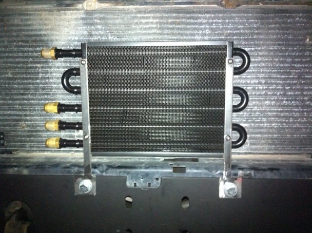

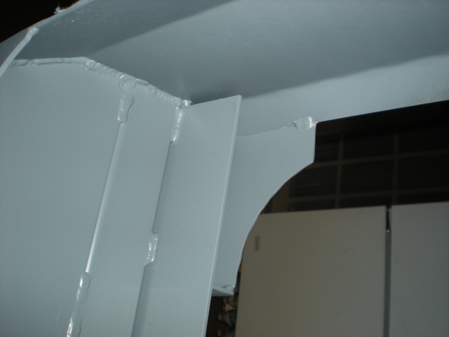

Now I'm mounting the Rigid bulkhead reinforcements and getting ready to install a dual circuit oil cooler to serve as both a transmission and power steering cooler. Just need to decide on how the hoses will be routed to ensure that they won't be cut in the event of another front impact.

I also welded up some 1/8" steel strap brackets for my transmission/power steering cooler:
I'm thinking that sadly I'm probably going to go with barbed fittings and the stock transmission lines for now, as I can't justify nearly $300 in plumbing for this project.

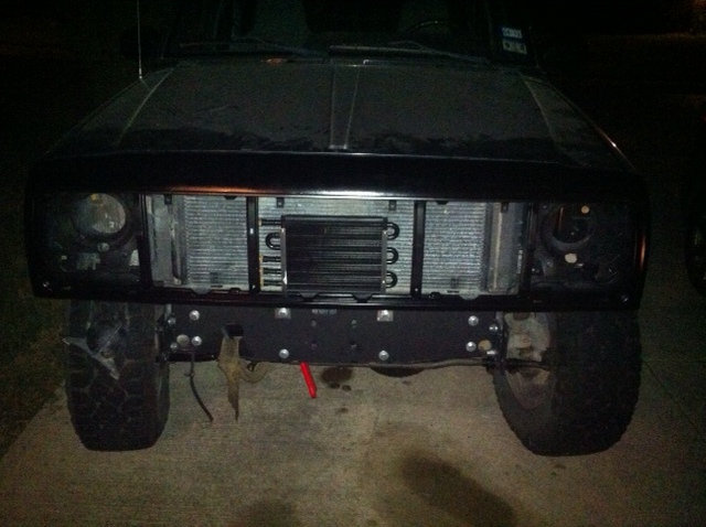

I'll take some pics, but here's what's been done thus far:
  • Vacuum canister has been relocated to the driver side of the engine bay near the firewall (right beside the brake booster and master). To simplify plumbing, I removed the tee fitting at the cruise control module and stuck it directly onto the line that runs along the firewall. At the source of that line (the rearmost port on the intake manifold), I installed another tee and fed the line directly over to the canister's new location. I'm thinking this should work just fine, but we'll see.
  • New fender and front fairing have been painted and clearcoated. Waiting til tomorrow to mount and wet sand/polish them. Never using Duplicolor again, though (pain in the ass, especially black).
  • Transmission/steering cooler brackets have been painted, currently drying.
  • New power steering pump has been installed. Broke the hub on the old one trying to pull it, so I'm picking up a new one at the dealership today (no need for an overdrive pulley with my 30s).

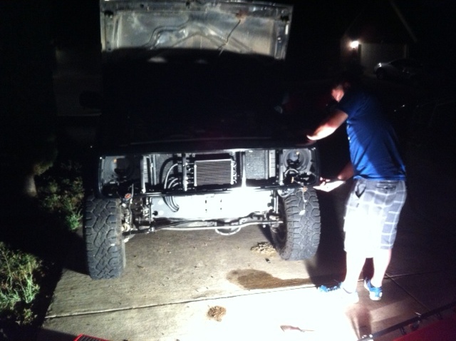

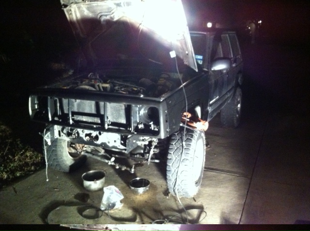

Went to the bar last night, and got home rather late... But a buddy insisted on staying up and helping me align the body panels:
We eventually called it quits at around 3:15 AM (my dumb ass kept drinking, so I'm quite surprised we didn't screw anything up).
A daylight shot of the progress:
So freaking close I can taste it.
Only problem is that the "new" power steering pump I bought from Advance Auto is leaking... It appears as though the leak is where the reservoir mates with the pump, however, I replaced the "new" reservoir with my old one to no avail... This evening I plan to pull it off (yet again) and re-seat the reservoir with some RTV for good measure. If it *still* leaks after that, I'm taking the damn thing back and buying either an OE unit or something from O'Reilly.
I must have missed it, but what crossmember are you running on there with those bolts. Forgive me if it is stock, it looks different than an old one.
