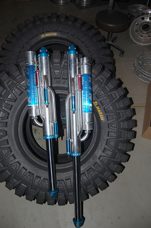

Here is a picture of the new shocks we are going to run on my car for the race.
Yeah, Dave's going to be super blingin'. :D

Got the rear gears installed, so 5.13's now instead of the 4.56's. Lost some low range speed, which I really liked, but we need the power for the fast sections. We're going out this Sat, so we'll see how much nicer it is at speed with the lower gears and I'll do some more tuning on the rear ORI Struts. I'm waiting to hear when the front ORI's are coming, hopefully in the next week or so.
