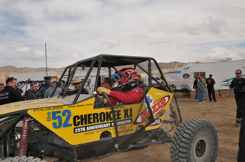

Here's a little more info about how we did in the last race. In the prep work that we did, we missed protecting the air locker lines from potential heat problems. It hasn't been a problem on trail runs, but running for so long at a much faster pace produced heat we didn't anticipate, and we blow out the rear air line before we got to the first trail. We spent about 6-8 minutes in a pit stop getting that line fixed and got passed by a bunch of rigs. Then we lost both air locker lines by the time we got part way through Sledgehammer, and broke the rear driveline on Jackhammer.
Still, by studying all the split times, we were in 9th place when we broke the driveshaft, which was about halfway through the race, just past check point 7 (out of 14). By the time we got the new driveline to us and installed, and fixed both air lines, and got to the next check point, we were in 15th place. We actually passed 4 rigs that had passed us when we were broke by the time we got to the next check point. From the time we broke to the end of the race, from check point 8 to the finish, we had the 4th fastest time. The 3 faster times were the guys who ended up placing 1st, 2nd, and 3rd. On one section, from ck 8 to ck 9, we had the fastest split time of the field, which we are pretty proud of.
The race will be longer, and there will be almost twice as many entries, 75 this time and 43 last time, and plenty of trick new rigs are being built. But, we're also making improvemnts to our rig and we know that we can be faster. If we can do a great job of prepping the rig, and are fortunate enough to not have any major mechanical problems, we think we can do well again. We'll see next Feb.

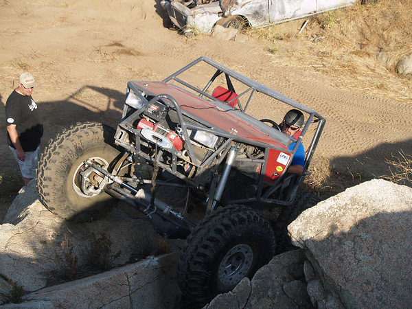

As you can see from this shot my roof is a little low. You need to have 3" over your head with a helmit on.
Looks like Rigworks is going to help us out with some new quality cage work.
Richards buggy got the first major rounds of mods done this last week. Left my shop late last night. Maybe he can toss a few completed pictures up for us!
Matt and Ron, you guys at Rigwerks need to market that crossmember/belly pan skid, that thing is bad ass! Unquestionably the stoutest and best designed crossmember for an XJ/MJ that you can get.
I'll try to remember to get some shots of it installed this weekend. These pics don't show the rear attachment points, which really make it mega stout.
And yes, I'm pimpin' for my sponsors. :D
Scrappy and Capt Ron had the buggy at Rigwerks for a few days. They made new LCA frame mounts that relocated the mounts inside the frame for tire clearance, finished a complete installation of their belly pan, finished off the rear of my storage area under the seats, re-did my rear track bar mount on the axle, mounted up my front coilovers after Paul took them over to Sway-A-Way for some revalving, and helped me mount up my new ORI air struts in the back with some brand new mounts.
