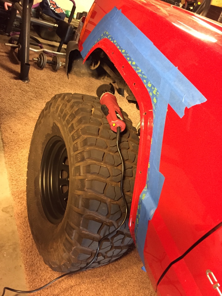

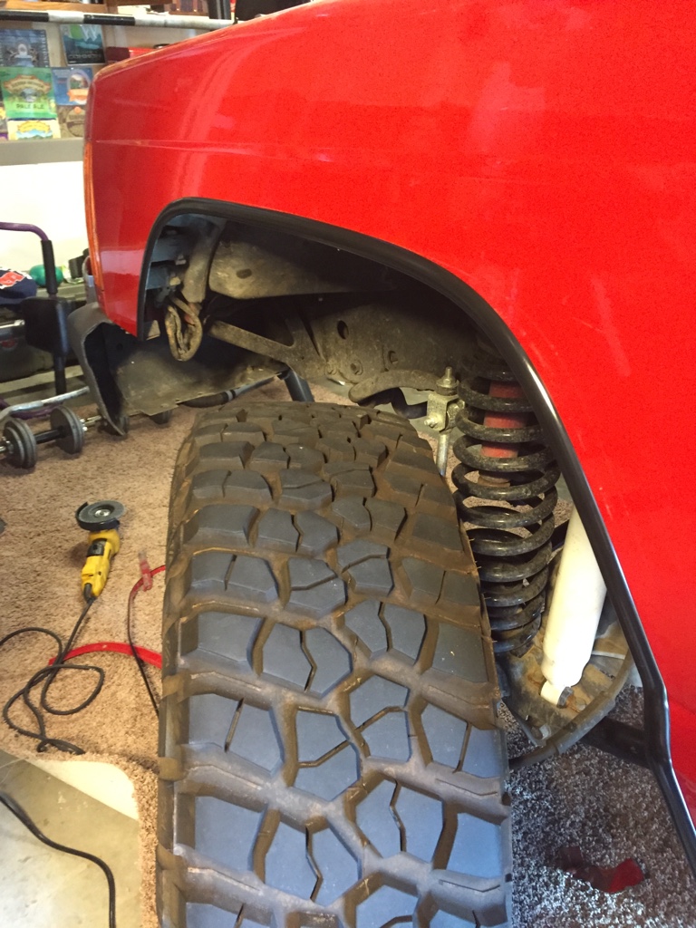

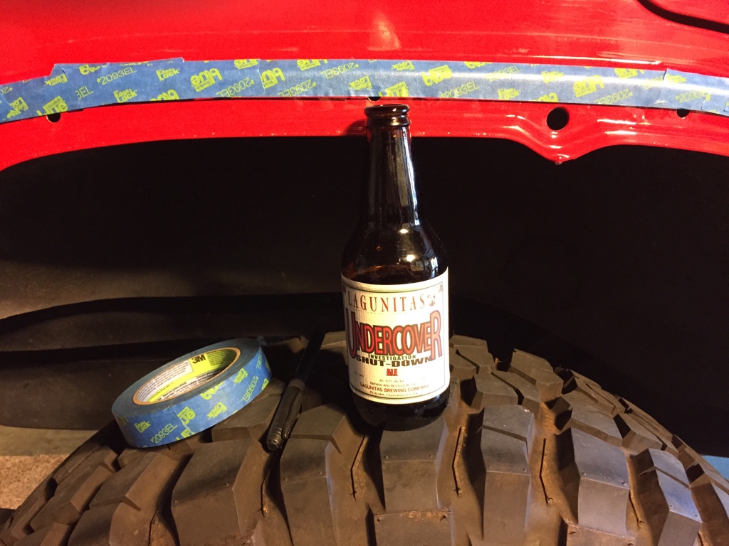

This is what I did to my front fenders. I have 3.5" of lift and changed from 31s to 33 12.50s and there was a ton of rubbing. I couldn't even turn my wheel 1/3rd of the way around before the back of the tire hit the metal part of the fender. Trimming is a must IMO with 33s and that little of a lift.
