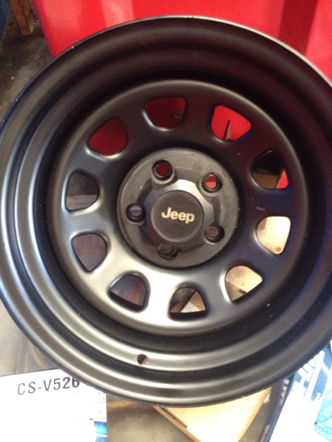

Stock Jeep Center Caps on Cragar Steel Wheels (How-To)
I was actually thinking about doing thing when I first got my soft 8's. Same concept, and I saw it on one of AEV's Commanders. Looked really sharp for the price, and surely a hell of a lot better than those retarded Ben Hur chariot status chrome center caps.
