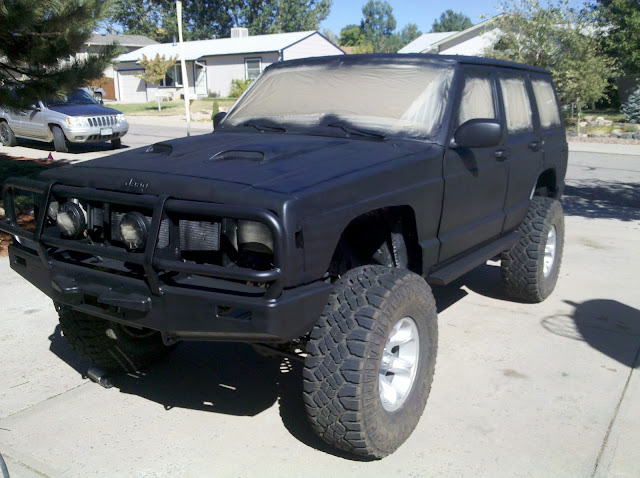

Dean (RynoXJ on here) used Durabak on his whole jeep, and it looks great. pretty tough stuff as well and it doesn't fade like rhinoliner and line-x tends to. cheaper as well.
